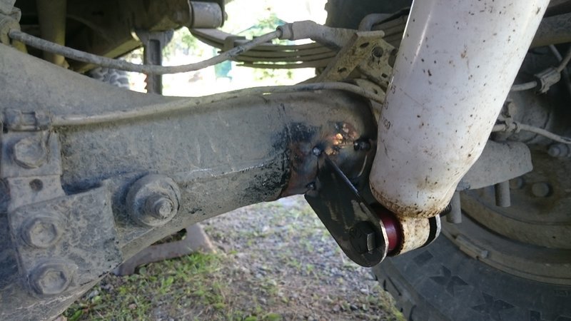

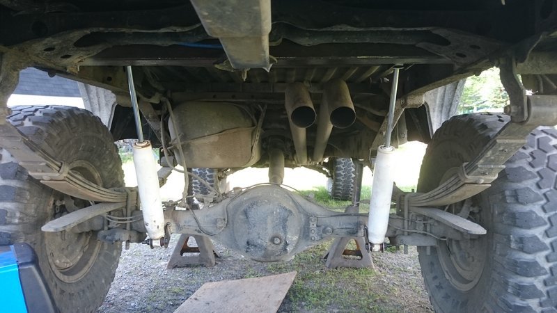

    I slapped this together in a few hours with scrap that was laying around. Currently some 10" 5125s in there.

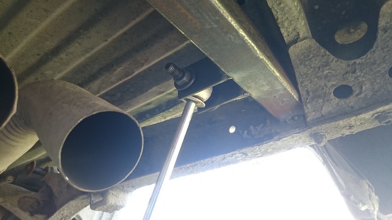

    I wasn only going off of full droop making sure the shocks didnt act as the limiting factor. I knew those skyjackers had enough travel that i shouldn't need to worry about bottoming them before hitting bumps (not on in pic)
    You would normally break pack down to main leaf and compress the suspension that way.
