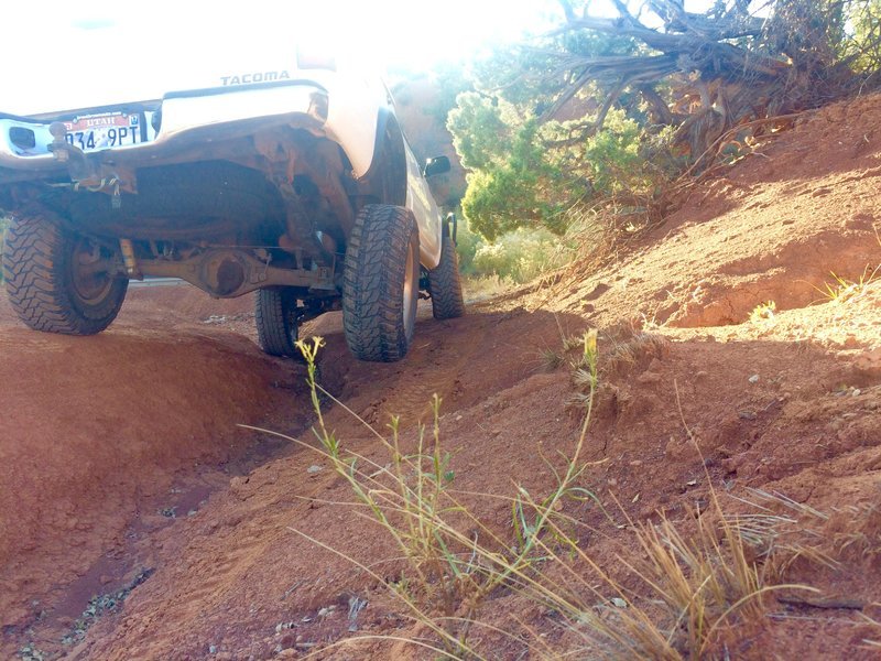

    Here is another pic of my OME rear.

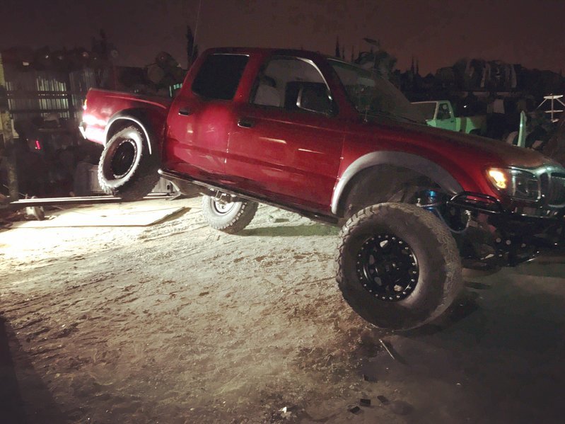

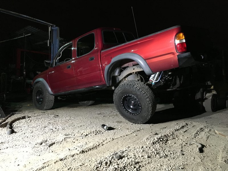

    I blew the seals on two shocks. One Nitro, and one extended travel Rancho, on the same side. So, yes, you can damage they shocks.
    You will lose at minimum 3" of down travel.
    Dakars, Nitro's, full droop of both. A pic is worth a thousand opinions.
    Photo courtesy of @Madjik_Man

    While flexed that side will want to droop a little more than that aswell.

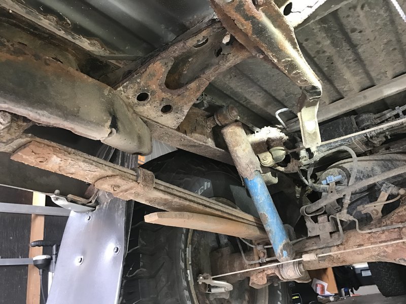

    I'm running this too and that's exactly what my rear looked like during the install. I've been running this setup since the spring and everything looks fine, but I know I'm topping them out pretty easily because of how low the leafs droop.
    I'm just waiting to hook up w my cousin to weld in my crossmember and shock brackets.

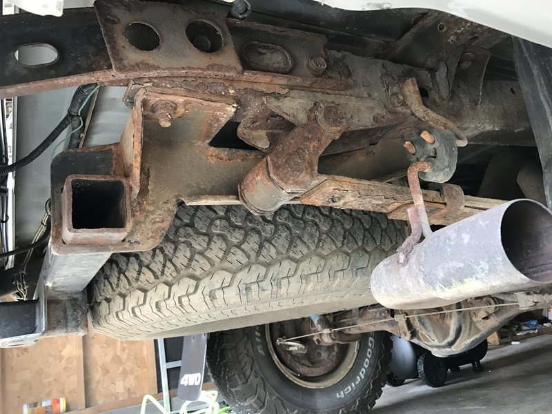

    I thought if you worked on your frame or coated it yourself the Toyota recall would be void. I hope you made sure. That looks pretty bad.
