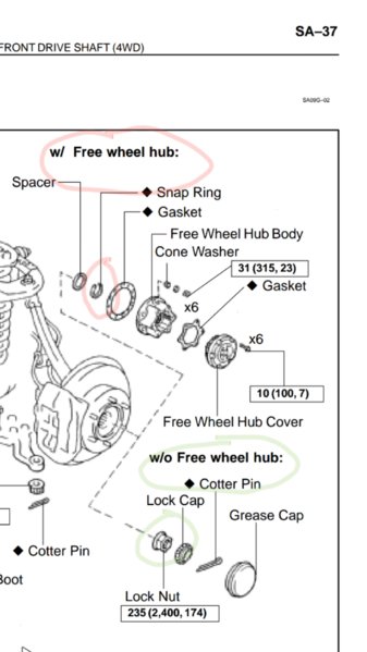

    There is a c clip that goes on BEFORE the manual hub!! the bolt an washer are for add front ends and the pre-tacoma pickups.
    The threaded hole at the end of the cv goes unused. I am 100% sure. let me find the fsm page.

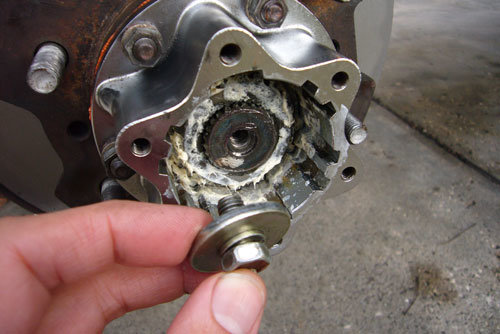

    Haha, no! I really don't want to take my hub apart to show you that's wrong so here's a pic from another member...
    Bolt and washer in question, they are just there to stop the CV from partially engaging the splines when they stretch during flex and turning. You're partially right though, there is a C clip holding the other side in the axle tube and a looser fitting circlip that holds the shaft in the rear of the hub body.

    Got it!

    My tacoma has no bolt there. And the fsm says nothing of removing said bolt to remove the axle or hub. I thought something was missing until i reseached the crap out of it. my pre-tacoma pickups with manual hubs had that bolt. My tacoma does not.

    I was the first to take apart my hubs and both mine had the bolt it seems like it's just backup retention for the free wheeling assembly.
