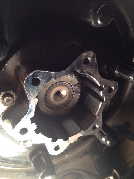

    This is what I've got:

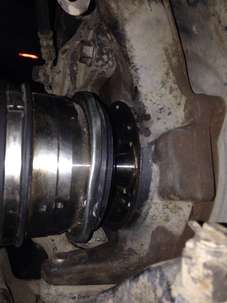

    I'm outta ideas here I put together everything I had

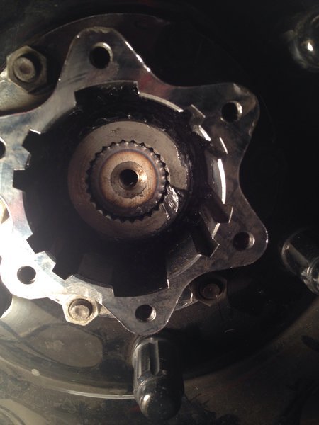

    This what mine looks like. But i dont have the play (understatement) that you have my stub shaft will not move inward at all.
