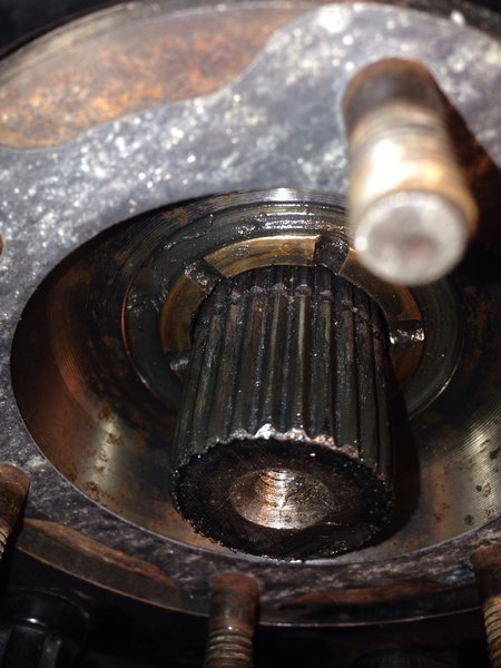

    It's less Tacoma and more mod
    Once it is off you should be able to tell if your clip is on the axle stub or not.

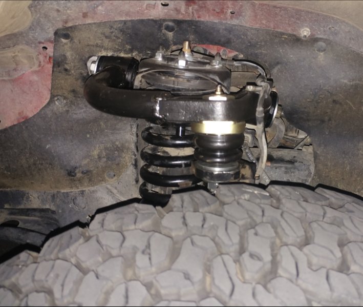

    Got my new SPC Light Racing UCA's put on last week and had the 5100s adjusted from 0 to the first setting (.85) to help get rid of the massive rake I had going on previously (still a bit of rake but doesn't bother me anymore)
    Loving the new UCAs

    Agreed. Interesting to find somebody with a 1999-2000 WITH the bolt.
    Speedytech7[QUOTED] likes this.

    Everyone else's I've seen has been a clip on the very end of the axle. So now I know what I'm missing lol. Sooooo where do I get two of them?

    There's your problem lady

    @MstrYota I think my axles came with the spacers and clips, don't really remember I've only rebuilt the manual hubs twice and the first time I didn't change the axles.

    There is a washer that goes on before the circlip that you are also missing.

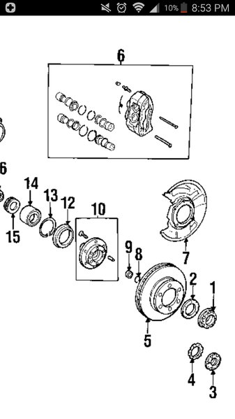

    Does toyota sell the clip and washer?
  14. Oct 30, 2016 at 7:44 PM
    Speedytech7
    Feb 20, 2014
    #123587
    58,092
    FCQM+VG Cheney, Washington
    That I don't know, if you can find an exploded view of a CV axle for a manual hub Tacoma then chances are it'll have the part number of the clip and spacer washer and you could then order it.
  15. Oct 30, 2016 at 7:45 PM
    retroboy1989
    retroboy1989 Single Cab 4x4
    Apr 8, 2016
    #183693
    738
    99 2.7L 5spd 4x4
    I think the clip is: 9052027023
    And the washer is: 90560-27005
    Speedytech7 likes this.
  16. Oct 30, 2016 at 7:51 PM
    Speedytech7
    Feb 20, 2014
    #123587
    58,092
    These both sound right when I looked up their description on Camelbak Toyota but of course their stupid site design doesn't let you see the part diagrams when you search by part number. For the 2.50 per side it would cost to order these parts it's worth the chance though.
  17. Oct 30, 2016 at 7:54 PM
    MstrYota
    MstrYota Great balls of fire!
    Mar 7, 2016
    #180558
    447
    Daniel
    Ventura County, CA
    2000 TRD 4x4 Prerunner/1998 TRD 4x4
    Too much but not enough!
    You guys are life savers. Much obliged :hattip:
