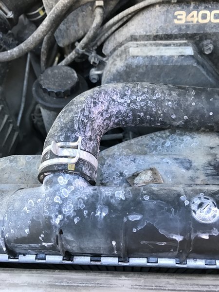

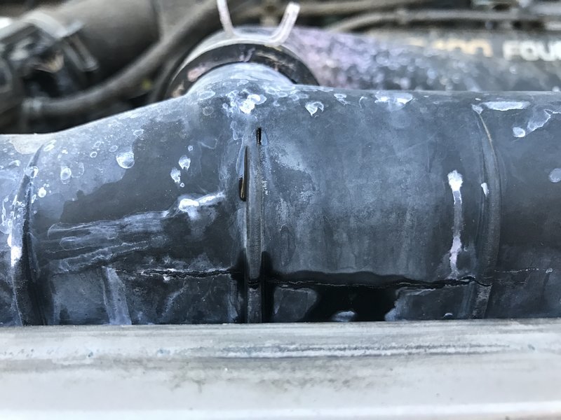

    I have a crack as well except on the driver side. It doesn't really leak but I've known about it since installing my s/c about a month ago. The trucks been fine.

    Replacing it is everyone's 1st option. Sometimes you have to make due until you have the money. Yeah, not replacing it means taking risk.
    There's some good apoxy's out there to that works good.
    Replacing it wasn't hard, as koditten said. Like I said above I purchased a new Denso #221-3138 for $100 on Amazon. No shipping charge or tax.
    I would not use leak stop, ever.

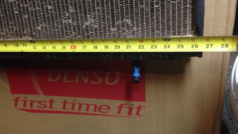

    2002 V6 4wd automatic-
    Core Dimensions
    • Height: 22.75"
    • Thickness: 1.25"
    • Length: 24.625"
    http://densoautoparts.com/find-my-part/vehicle-selection

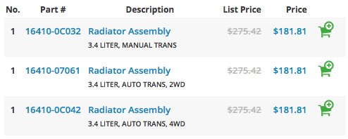

    These are the part numbers that come up from my local online dealership.
    The first listing is the only one listed with Manual transmission. That top part number cross referenced to a TYC radiator and it gives me the 20 3/4" that Koyo also gave me for the manual transmission.
    I just got off the phone with a dealership and they confirmed via my VIN that the first one is for my truck. Same as yours @Madjik_Man
    Thanks again to all you folks.
