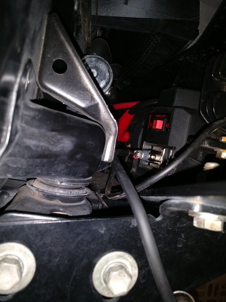

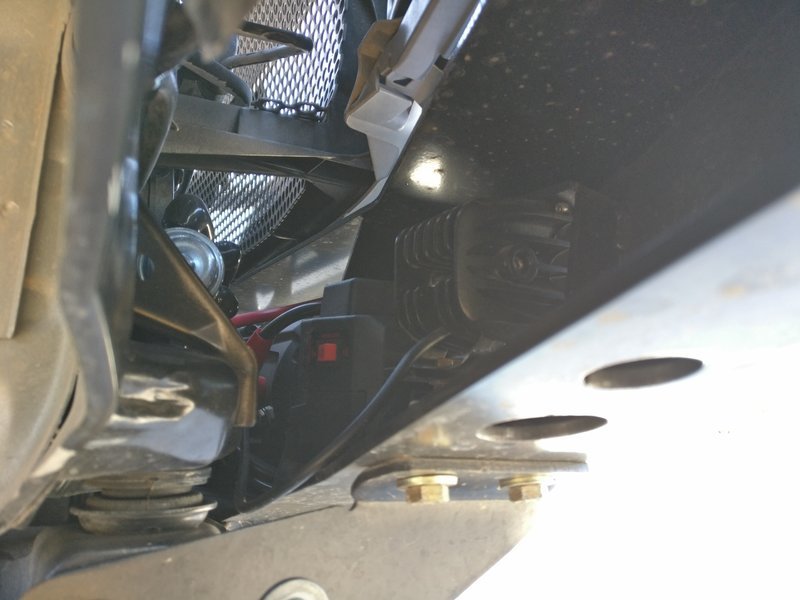

    Anybody know if someone makes a 90° 5 pin adapter that would plug into the winch solenoid? Mine is mounted in the bumper and I use wireless but the wired cable won't fit but is very close. I want to make sure if the wireless goes out I can wire in. Thanks!

    Extend the wires on the plug. Then put it where ever you want. Cheap and easy.
    Granted you'll have to drop your bumper again it looks like.

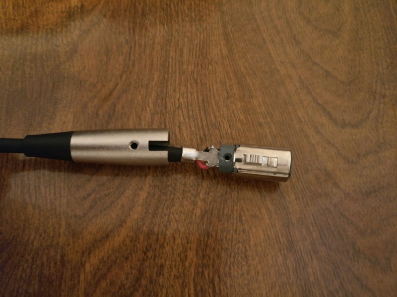

    Wait, solved it. Just had to take off the piece that goes around the wire and it leaves enough room to fit it in.

    Still water proof?

    The only time I'll plug it in would be when I need to winch, so other than that it will all be sealed up so yes.
    Just took the remote cable and unscrewed it and slid it back so it could bend a bit easier.

    ohhh the connector on the cable. Thought it was on the solenoid.
