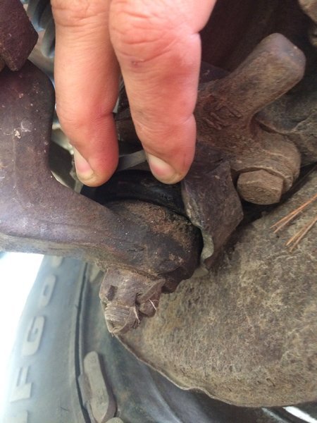

    Yeah I need to investigate a "clunk" coming from my front passenger side. This clunk is only heard/felt when I turn into the driveway. I could not find any abnormalities on visual inspection, so now I need to jack up the frontend and evaluate LBJ play. Just wish it would stop raining here long enough for me to do that!

    I hear that, I'm clear weather dependent too when I need to wrench! Many people have report clunking before finding out the LBJ's are toast. Look for grease leaking, even if the joint feels tight. It wont take long for it to dry out and fail. Mine are rock solid, but when I stuck my finger under the rubber guard, there was grease built up and sure enough I found a tear in the boot. No bueno

    No grease anywhere but I am concerned about early signs of fatigue. I upgraded my wheel and tire set this spring and am wondering if the added weight has anything to do with the clunk I'm hearing. If I don't find any LBJ play, I'm thinking about replacing them anyway for peace of mind.

    'Cuse the rust, but this is the condition of mine. Its been leaking grease slowly, so its all dried up and stuck on. Right at the pointer finger is a tiny tear. I think this side is on its way to fender crunchin' fun soon :bananadead:

    Boo

    They are really not that hard to swap out.

    Thats good to hear, but yeah I'd be worried if they have seem some mileage. I agree with others, these need to be considered a wear item and replaced. The peace of mind is worth it :thumbsup: I'm also pushing 33's, and believe without a doubt thats accelerating wear on a lot of things up front :anonymous: Gotta pay to play :cool:
