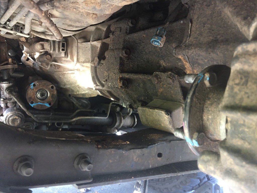

    Finished my 2 low mod.

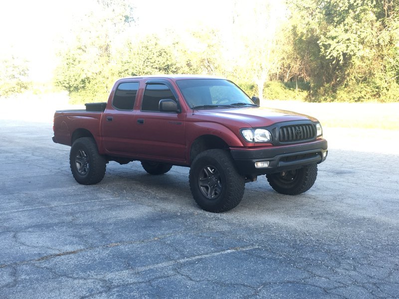

    2,725
    Supercharged TRD
    TRD S/C, ADS coilovers.
    IMG_1489.jpg Cambirg UCAs, BORA 3/4 spacers, windshield tint.
    Haven't added any grease to zerks but gonna go by grainger to pick up some super lube tomorrow.
