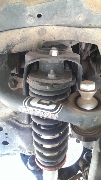

    That aint a lift poly spacer btw. just the one used with the rancho struts.

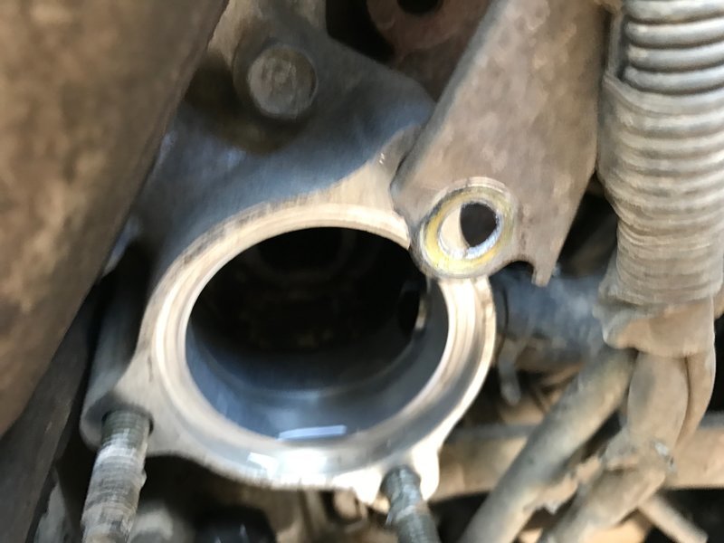

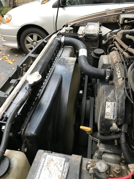

    You installed the jiggle valve exactly how it should be. When I did my timing belt and water pump a few months back, and after watching several videos on it where they said to install the thermostat with the jiggle valve at 12, I installed it with it at 12. After doing so, I noticed that my truck was running warmer around 198-204 F. I tried flushing it, tried running it with just straight water and some of cooling additive for a short while, and checked the cooling system pressure swapped out radiator caps, made sure my radiator wasn't clogged-- all these things yielded no improvement on the running temperature. The last thing I tried was switching the jiggle valve position on the thermostat to 6 oclock. That was it. It did the trick. Now my running temps range form 188-192.
    There are plenty of threads where people have had the same experience.

    Nice work. What is the difference in installing the jiggle valve at 6 vs 12?

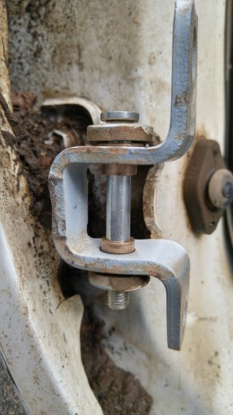

    Did the new bushings help keep the doors from slamming on you? Also, where did you order the bushing from?
