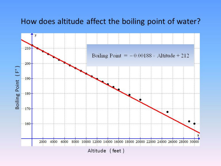

    Another thing that probably wouldn't matter much to flatlanders is boiling point vs altitude. It drops about 1deg per 500'. At 13K straight water with a leaky radiator cap boils below 190.
