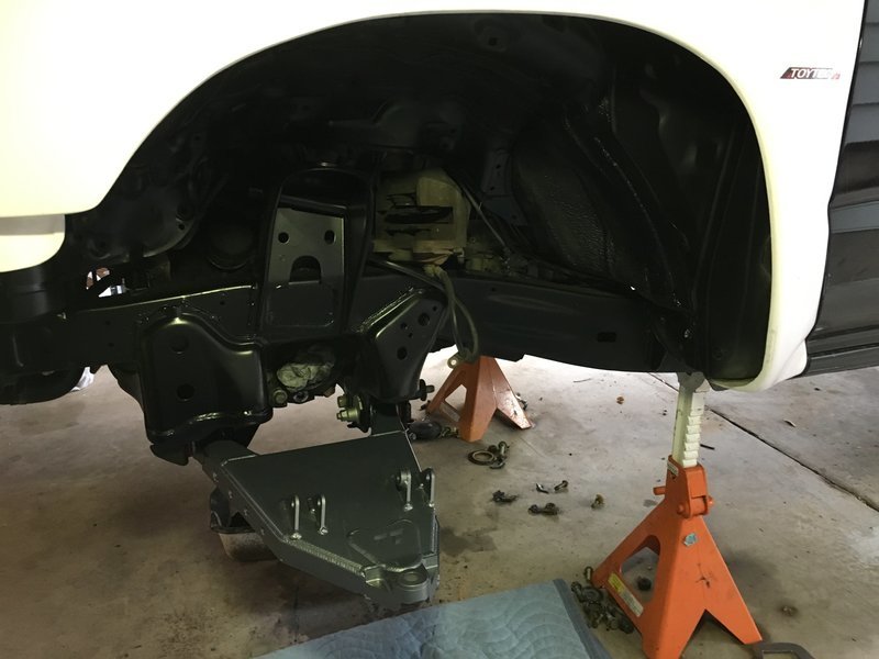

    Dang undercarriage is clean

    We made it fabulous :D same with the back. Just need to look at the middle still haha.

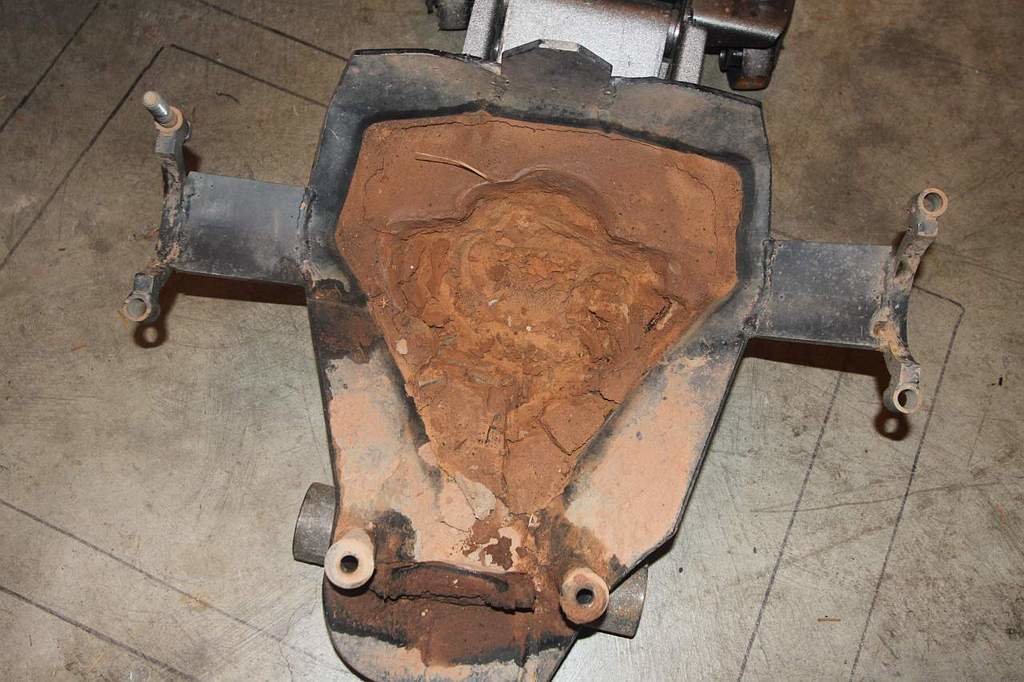

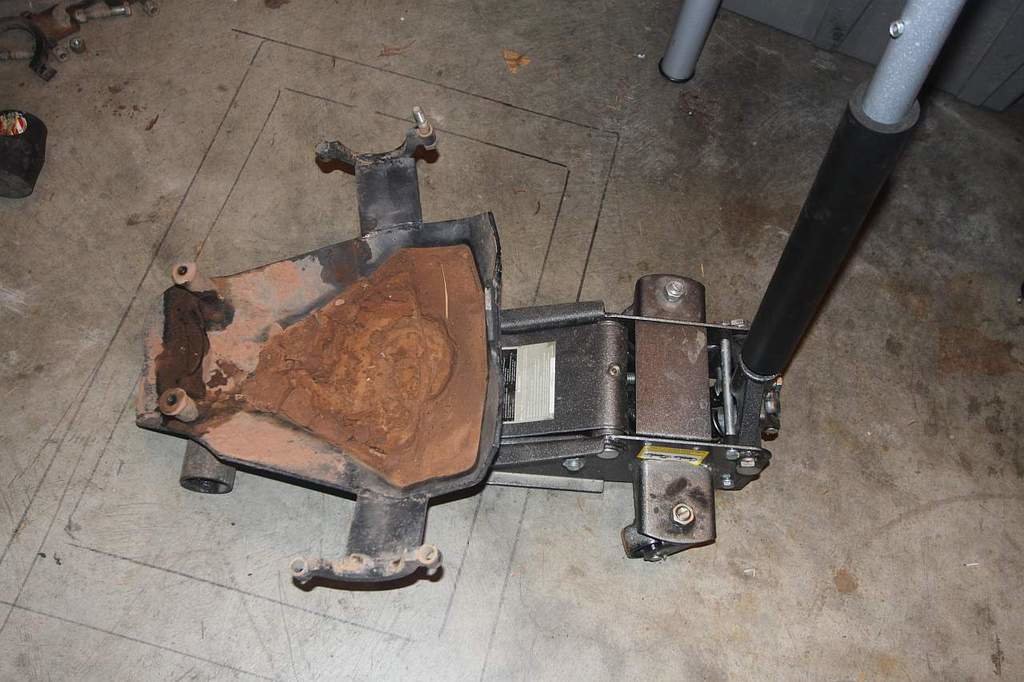

    I was asked by a friend to bring back some 'moab dirt' for a special event from our recent adventure. Little did anyone realize that the diff diaper would be the source. :laugh:

    I need to make a diff skid, really needed one the other day.

    Got quite a bit of dirt in there. Makes me wanna have a skid plate for my rear diff.

    What diff skid is that?
    Ive only seen the weld on ones that do little in protecting the bottom where I’ve been dragging it recently

    Thats a Bamf diff skid. Before they where discontinued. Love mine too. Think Jerry was doing a 1 time group buy on them again...at like..$450 a skid or something crazy.

    It's a BAMF, pretty sure he's currently doing a limited run of them again. But he only does them every once in a while so you may have to get in line if the near $500 price tag doesn't scare you off.

    No that was me. But i got it for free at Moab. It was warped. Easy fix.

    I can see why the cost so much. The pieces he has to cut and then bend into odd shapes to form it and then weld the 1/4'' and keep it from warping. It would be a bitch. Not something he can just let his normal guys make.

    1/4" plate and a good welder and I'm sure you could come up with something just as good. I plan to do a 3 or 4 piece bottom pan (to achieve the curve of the diff without bending plate cause I don't have an ironworker) weld them together and then use 3.5in 1/4"wall pipe cut up to make clamps.
