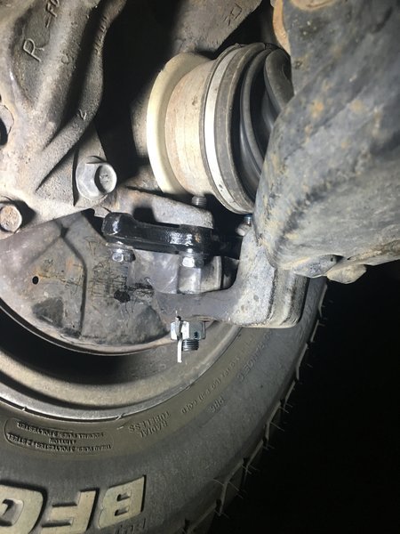

    Paint mark those bolts so you can tell if they move easily.. some have a bad habit of backing themselves out

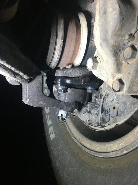

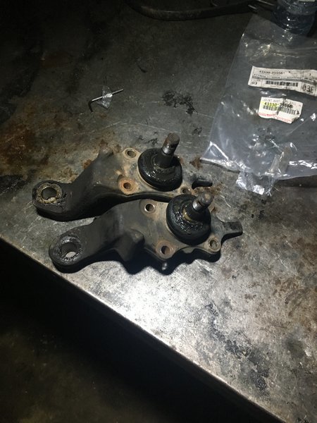

    Yeah I need to do that. Put a good dose of loctight on them. But it got dark on me. Fortunately all the old ones were good and tight and stayed tight without any loctight

    I replaced mine about 2 weeks ago (with loctight) and they came loose 2 days later. Thankfully I paint marked them.. now a firm believer in paint marking :D

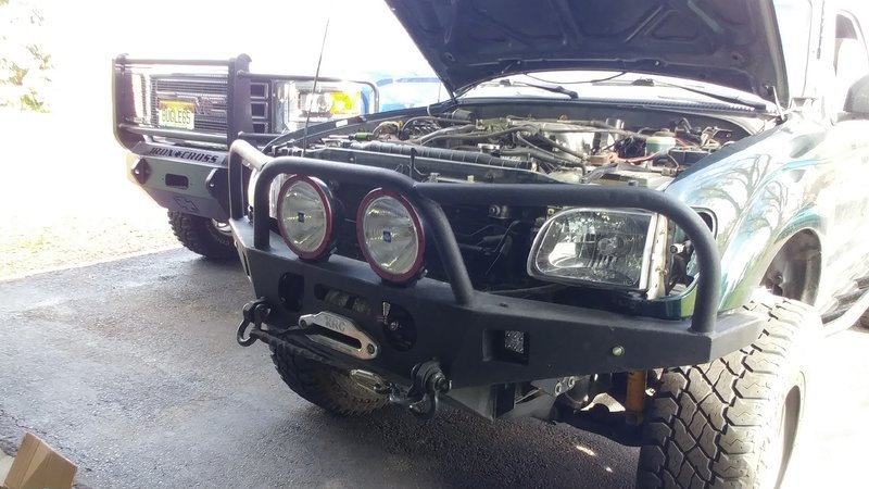

    I like these too
