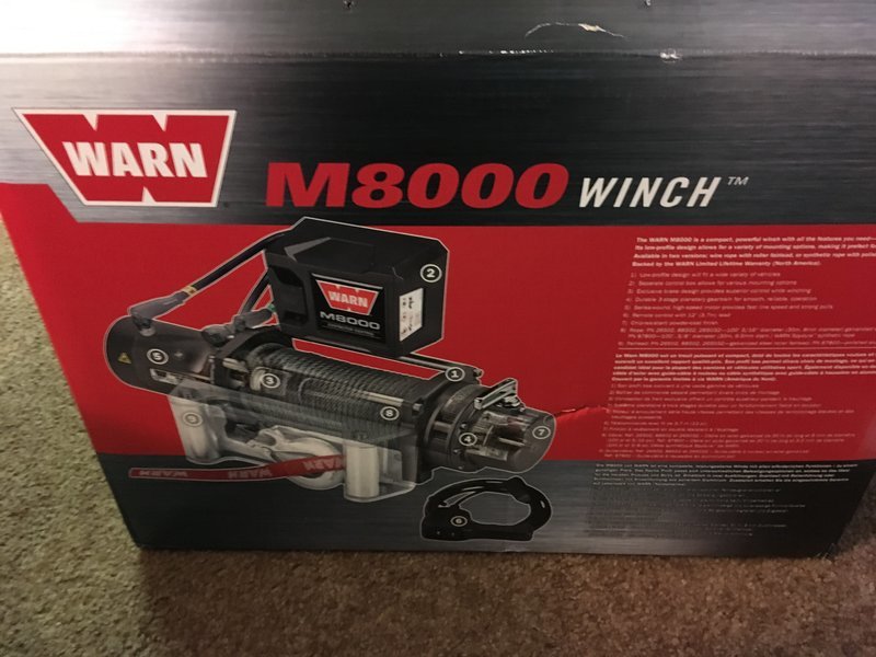

    16x8 Raceline Assault Rims K&N Cold Air Intake Flowmaster Super 44 Exhaust Spyder euro style smoked headlights Spyder Smoked Tail Lights & 3rd Brake Light Weathertech Floormats CBI Moab 1.0 (front) & Trail Rider 1.0 (rear) plate bumpers Warn M8000 Winch Custom Grille
    IMG_0417.jpg Got a package in the mail yesterday!
