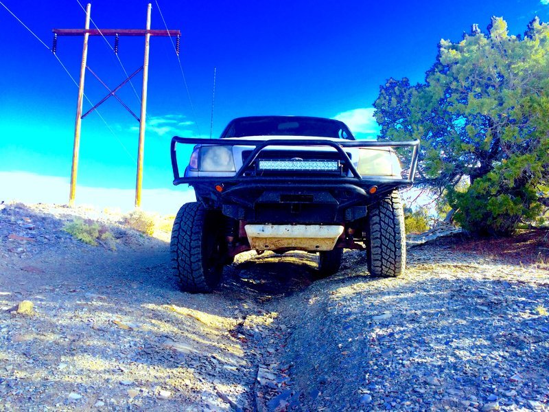

    IMG_1582.jpg New tires and such

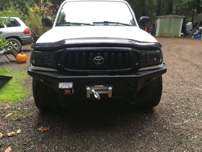

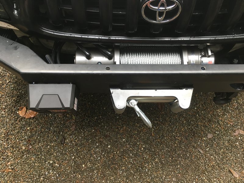

    IMG_0429.jpg IMG_0430.jpg Got my winch installed, ready to test it out!
    Just gotta figure out where to put my license plate now.

    Id relocate the solenoids behind grill.

    Thanks for the suggestion, I'll look in to another mounting location!

    Just have to get some longer wire is all. where it is now is pretty exposed. wouldnt take much to damage if it was bumped into something

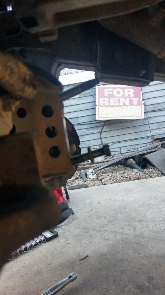

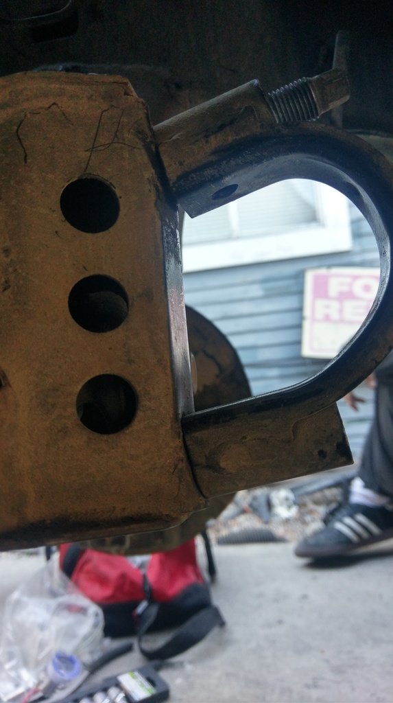

    did you jack the tires off the ground? when I did my bushings a couple of months ago I lowered it onto a block under the lower BJ casting (not the nut) and it moved out farr enough very easily without removing the tires or tierod ends.
    I had a LOT of trouble with removing the bolt for the vertical bushing... ended up spending a couple hours cutting off the lower nut with sawzall and a dremel and welding a new nut on the top hole instead of the bottom... those bolts are super hard.
    use ball joint press to get the bushing out... I did a friends 4 runner with a c-clamp and it took 5x the time and effort.

    also worth noting on the factory bushing's the big washer against the frame was welded to the metal center sleeve...
