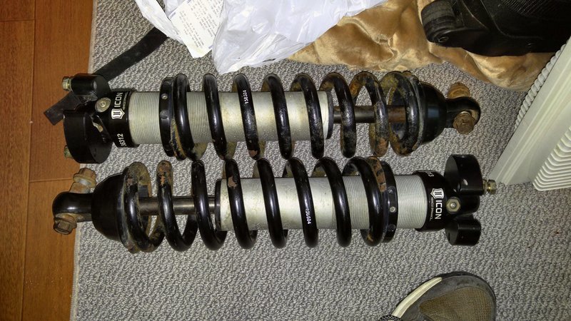

    882s sounds like they would be a decent choice, a winch will make a big difference as your hanging 60-80lbs off the front so it would calm it down for sure. I'd still recommend putting the 882s on the OME front shocks rather than 5100s. I bought a used pair of Icon Extended Travel front coilovers off another member on here. Just gotta swap coils to 600lbs and put in new lower heim joints and throw them in.
    Otherwise they are good to go... here is more info on them...
