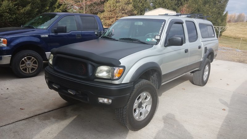

    I just wanted to be a cool kid :pout:...but that picture looks like it has a filter on it too but its 100% raw lol. Guess I had the sunlight at the perfect angle lol

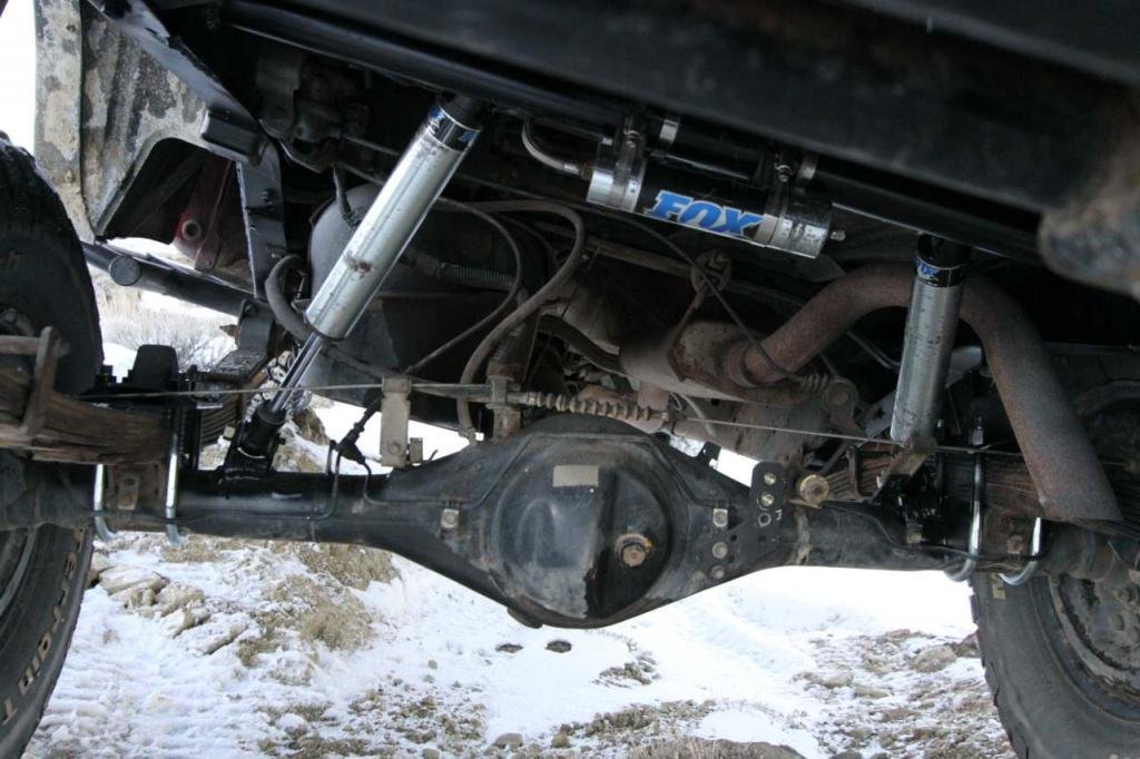

    What Fox's are you running?

    2" smooth body with resi.

    10"? I noticed they are mounted on top the axle.....I'm thinking after cycling my rear and measuring I want to go 11" 2.0s with resi using the BAMF kit...what was your final valving #s if you don't mind me asking
