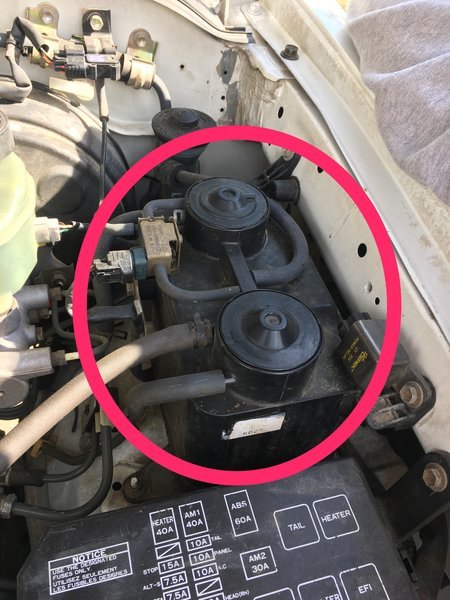

    So I turn off my truck and I hear a buzz sound. I look and feel all around and I see that it's this. I just don't know the name of this or part number can you guys help me out IMG_0425.jpg

    Charcoal canister.
    It most likely is the purge valve going to the canister.

    Common with your year and not hurting anything, just annoying. It is a chattering check valve and Toyota came up with a "fix" in 99. It consisted of a small chamber spliced into the lower line in the circle and glued to the canister. This provided an air "cushion" to dampen inertia pluses in the line. It is nothing more than an empty box. I believe the kit is no longer available.
    One could fab something up. Can be seen here.

    I have the same noise from the canister- it takes fuel vapor to depressurize the fuel tank so it doesn't explode and releases it into the intake- mine also "ticks" quietly at idle when it is cold out and there is little fuel vapor.
    the system is active for a certain time after the key is shut off so buzzing...
    both the dealer and a local shop I trust told there is nothing wrong with it and it is normal.
    they both told me not to worry and that it is totally harmless... it does absorb fuel vapor so might should get it looked at if you are worried to make sure the valve is not stuck and holding back pressure...
