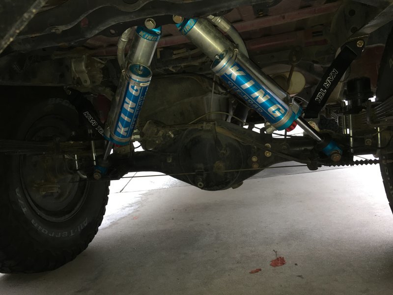

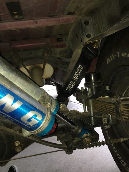

    Strapped the rear, adjusted the shocks again for a hair more uptravel and shaved the bumps, works better than ever now!IMG_4599.jpgIMG_4601.jpg

    You went with 12s? Sorry to lazy to click your build and read :crapstorm:

    Went with 10s.. the deaver j59 pack doesn't really give that much lift so 10s worked perfect and the pack still flexes amazing

    Word! Just ordered me some 10s too, not as nice as yours though.....just remote resis without the dampening adjuster....I have the AllPro standards but didn't want to go 12s, I believe AllPro claims 10" of travel and I'm gonna attempt to go more || than /\ but we will see....shooting for this https://www.tacomaworld.com/threads/tophers-build.303801/page-7#post-8867779

    Originally I was planning on running a setup closer to | | but the bamf relocation and those deavers weren't having it.. I would have had to run 8s to get them more like | | or angle the lower shock mounts down sacrificing clearance

    Yeah I'm probably gonna end up with the same angle as yours....but I'm ok with that! Just dreading my 4-8week shock build time

    Was just about to ask you....those are some damn Fosters cans for Resis :rofl:.......Berry NiiiiiiiCE

    Haha yea! I had to try a couple positions before they stoped rubbing with the tire

    Is that your parking brake cable behind the axle? Did you relocate it somehow? Mine sits on top of the axle.
    Edit-
    Not on top of the axle, but much higher than yours. Passes over my leaf pack.

    It differs from certain years

    It seems to vary between years. I can't remember what the reason was for. Mine is a 96, no ABS. and the cable is on top like yours.

    As stated by some of the other guys, it varies by different years. I probably would have preferred on top but...:notsure:

    I would rather have it like yours. With the dakars + the axle relocate plates, the cable rests on top of the springs. It's not enough to bother anything, but I don't think I could add the Dakar AAL without putting too much stress on the cable.
