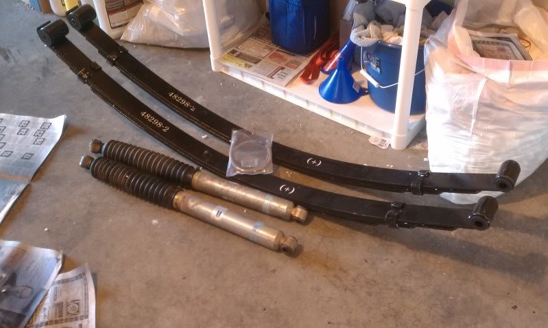

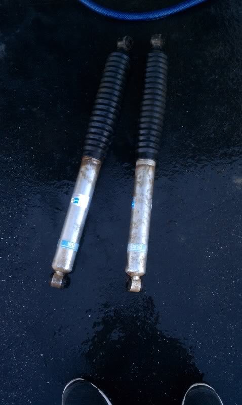

    Bought some 10" 5125's for a whopping $80 total!
    Tomorrow is when the fun begins.

    What kinda leaf springs and amount of lift?

    Downey 4" leafs. They're out of business now.

    Are those leafs the same part number and same length and height? Should be different driver and passenger side leafs...?

    They're supposed to be different length and height? Never heard/read that before.

    Nah he said "leafs" lol. And mentioned the part numbers....

    I think one of the leaf springs should be slightly taller. not 100% sure though

    Yeah idk, the ttora threads I've searched about these leafs all reference them by their part number of 48298-2.

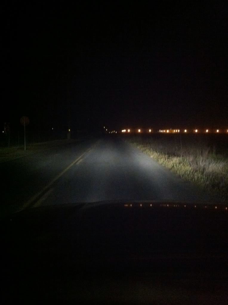

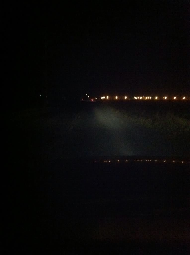

    Put some new lights on
    Before
    After

    Sorry, man, I left for a while.
    The stock leafs are side-specific. The Wheeler's Alcan leafs are side-specific. Same for Dakars. I put the old stock leafs on my bench side by side and eyes down, and one leaf's height at center was 7 3/8ths, and the other leaf was 8 1/8th.
    I don't know about Downeys, but that caught my eye. Maybe something to look into before you go through all the work of installing them and end up with an issue. Just trying to help...
