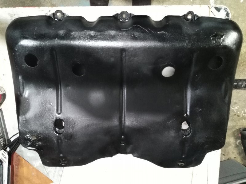

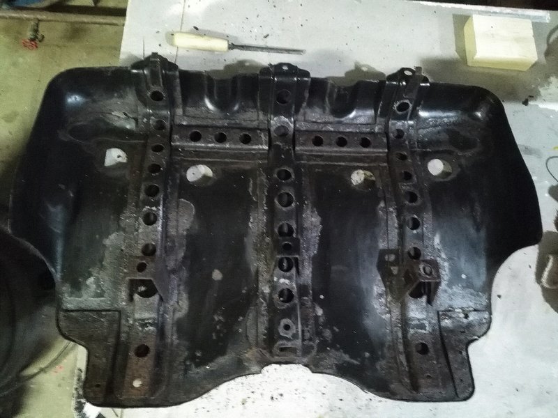

    Today I checked the front differential fluid because it was about time, and it has been leaking since I obtained the truck. Wasn't much lower than it should have been, so I added some. Also discovered I have a crack in the windshield washer fluid tank, but just by the top of the neck so it never holds enough fluid to be at the "full" mark. Whatever.

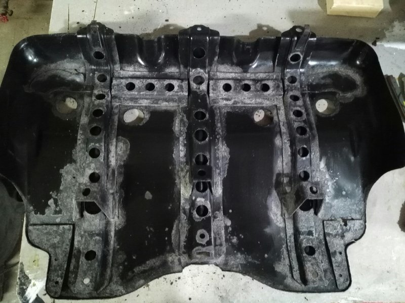

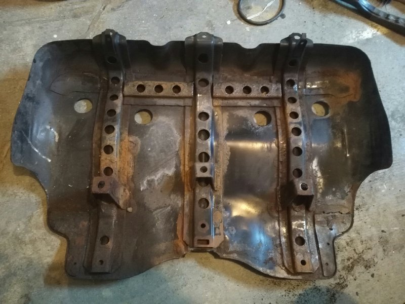

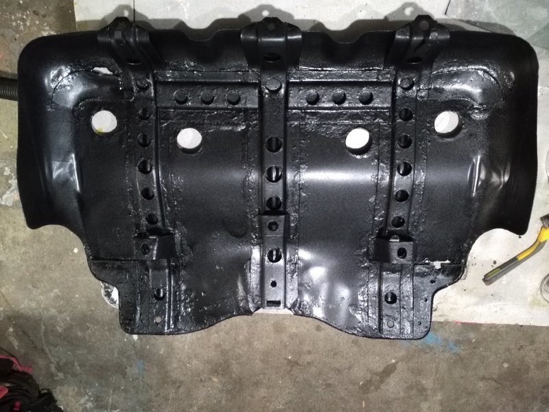

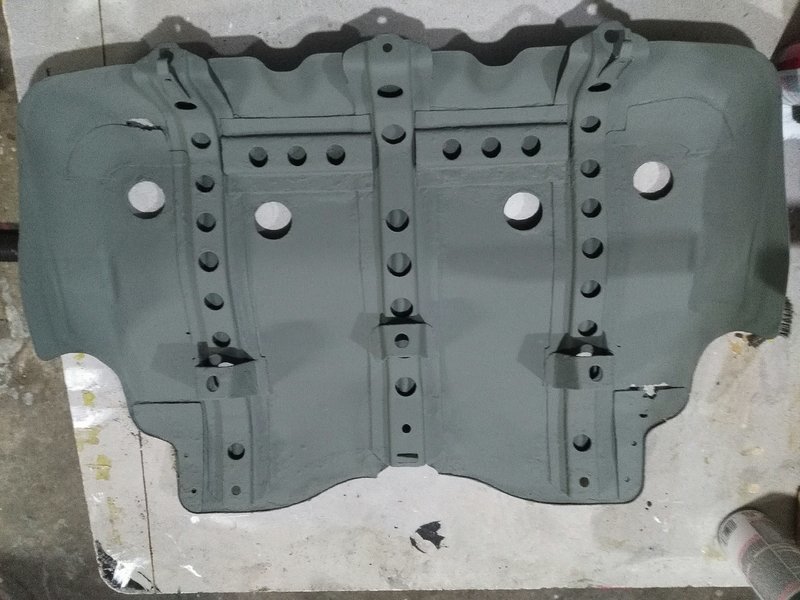

    Also finished "restoring" the front skid plate on the top side of the plate, having done the same process on the bottom already. Lots of grinding, chipping, wire brushing rust away, Rust Mort for eliminating and converting rust before a little sanding, self-etching primer and truck bed liner to top it off.
    Starting the chiseling/grinding/brushing away rust and chipping factory coating:
    After a coat or two of rust eliminator/sealer:
    After 4 coats of Rustmort + 24 hours time to dry:
    After a little light sanding and 2 coats of primer:
    After 2 coats of truck bed lining (still drying):
    A little touch-up truck bed lining on the underside. I see now that I missed some spots!

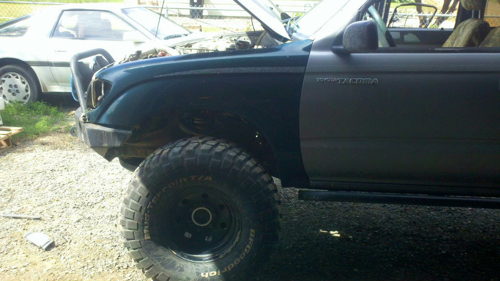

    There is.
    6 luggers fenders have a 1.5" or so "flare" or bulge compared to 5 luggers.

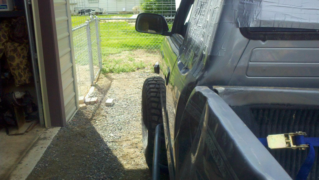

    here is when I tried putting 5 lug fenders on

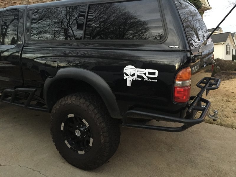

    Nothing fancy but added my new trd sticker , also im thinking it's about time to change rims any suggestions
