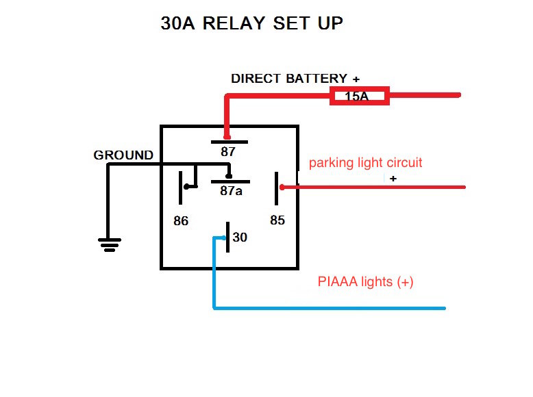

    This was my plan for the wiring .

    Yea if you do that it'll be fine. No need to tap anything with a fuse tap. Just tap the main power wire on the parking lights.
    Id still want them on their own switch. But that's just me.

    Yeah thats the other option. it came with a lame circle toggle but I could cut the wires and attach to a nicer switch

    Yea the stock switch is a bit lame. Easy fix though.

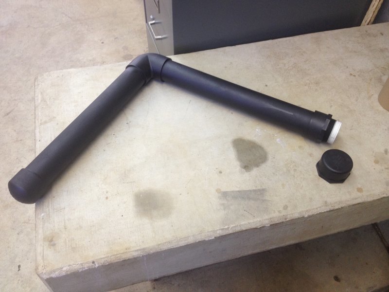

    Threw together a @Blackdawg style washer fluid reservoir. Hopefully I can get it installed this weekend, and hopefully that will be the end of my tire rubbing saga.

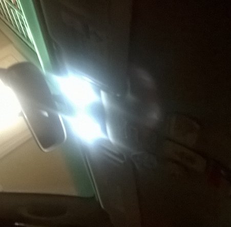

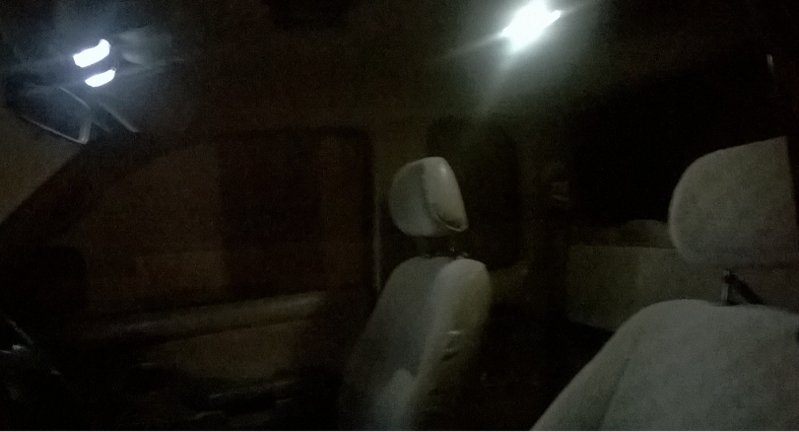

    Here ya go. Tough to get pics of a light but you can get the drift here. The light is MUCH whiter and useful vs. the tired yellow lights I had. Took pics in a dark garage in a vain attempt to show the sheer kick ass-ness of this upgrade.
    1st pic is taken through my tinted windows in a dark garage.

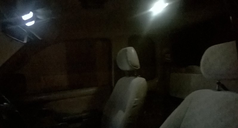

    Door open, map lights and dome on. Dark garage

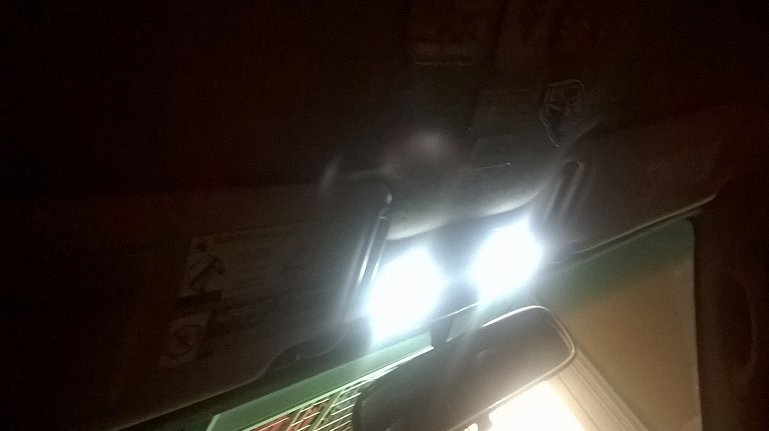

    Map lights

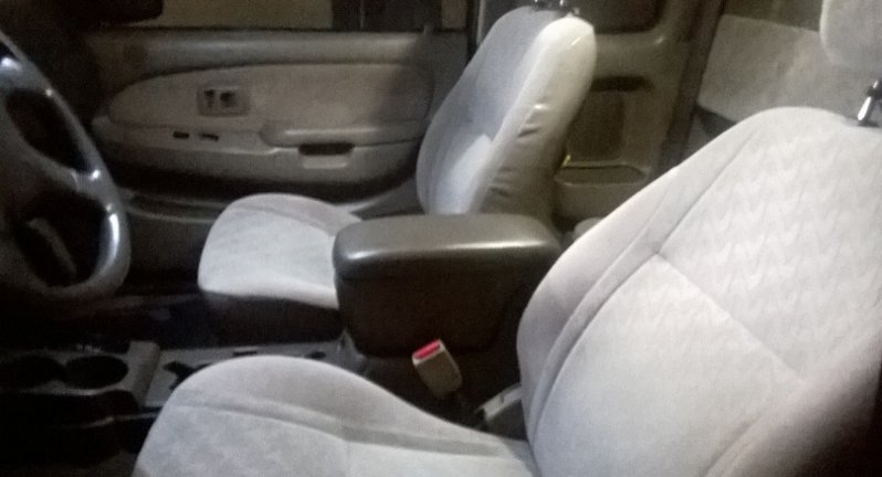

    Another pic of the map lights with me laying on the seats cuz that's how I roll.
    Get these leds from jumper. Worth the money and they work great.
    Hope the pics help. If not, then bite me! I'm going back in to take a nap.
