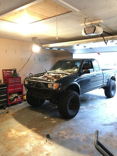

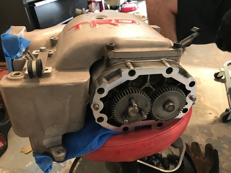

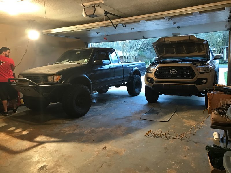

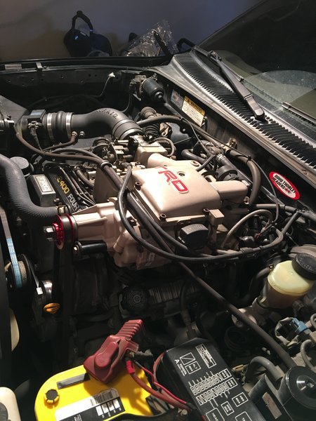

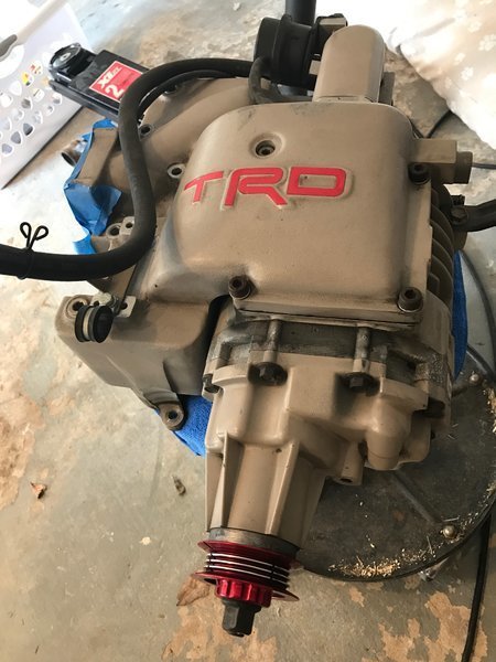

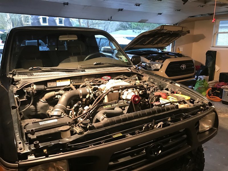

    Started some much needed maintenance.
    -Replacing spark plugs (IK22's)
    -Remove SC and change oil/phenolic drive adapter
    -Change all belts
    -Replace idler pulley (chirping)
    -Clean throttle body and remove/clean IAC valve
    -Replace all gaskets I come across
    -Change out hawk pads with OEM and new Brembo rotors
    -Flush brake fluid
    -PCV valve (debating catch can)
    -Rotate tires
    Oh, also completed the first oil change on @dYL0n 2017 Quicksand TRD Off-road :)
    Here's a few pics from the tear down.
