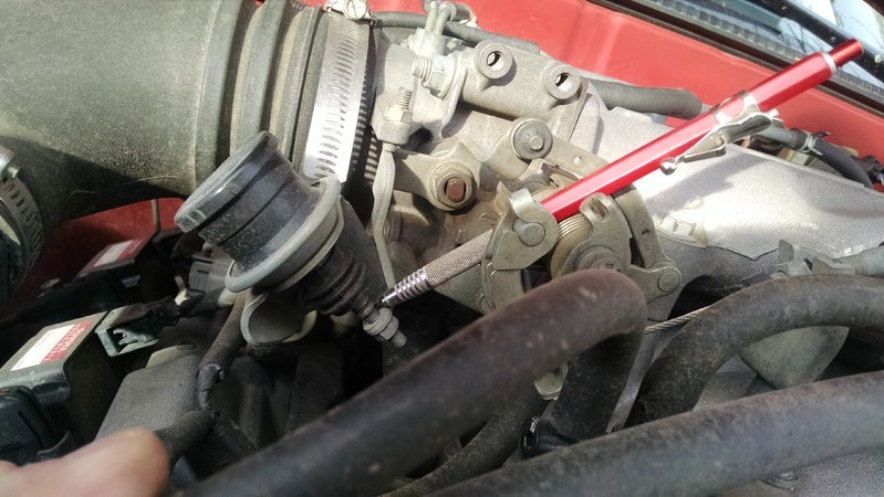

    did a little googlulating and found out its called a "dash pot" its supposed to slow down the last amount of throttle return to help prevent stalling with a manual trans.

    If you look directly above the pencil tip in the pic and just in the background, you can see the butterfly valve adjustment. it may not be a legit idle adjustment but it is another point to adjust the butterfly further closed.

    Yeah if I plunge that in a hair the butterfly seats fully.
    I think I'm going to leave it alone for now and see if the high idle goes away. If it continues then I might adjust it.
    If I adjust that screw though it doesn't seem like the "plunger" will mechanically sit further in. I have to push on it a bit in order for that to happen.

    Exactly what I just described. Plunger never did go any deeper, adjusting the screw allows the linkage to hit it less and the butterfly closes more.

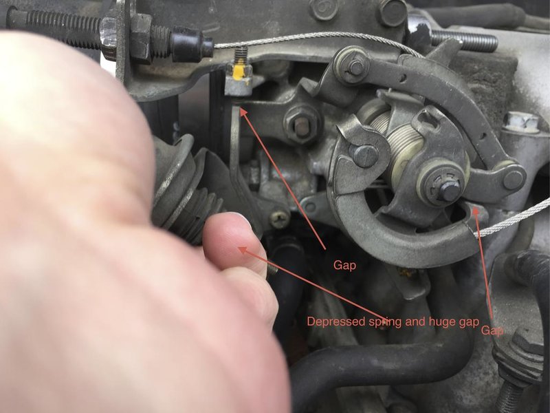

    Update:
    Put everything back together and fired it up. There's no more play to help it seat all the way. So I dunno.
    Of course it's idling high as fuck right one as it's relearning itself.
    Update 2: when I turn the truck off, the play in the linkage is back.
    I obviously have no clue wtf is going on.

    The slack is going away because there is a little vacuum diaphragm that pushes the throttle open and dampens the blow between shifts for manual trucks. It was sucked in allowing the butterfly to fully close but you turned off the truck and the diaphragm popped out to open the butterfly again in hopes of a smoother shift or a nice start.
    That is normal behavior just so you aren't chasing a gremlin that doesn't exist.
    In this pic its the thing this guys finger is in front of... I don't have a 5vz or I'd take some pics for you.
