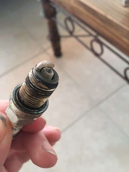

    What do you guys think of my plugs? I thought it may be running a bit lean but it looks quite similar to "normal" worn out plugs when I google images of plugs. This plug had the most white on the tip. The others were similar with more of a brownish tint.
    These plugs are IK22s that went ~37,000 miles. Little longer than I wanted to go (typically change them at 30k).

    You should be running dual electrode plugs from Toyota. Bronze plugs change every 30k
    If you've got the v6 5vz

    It's has been recommended for many years to run 2 step colder plugs (denso IK 22s which have the single electrode) with the trd supercharger.

    You're right my bad didn't realize you were SC
