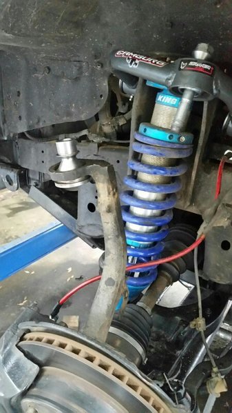

    well, seller was having an issues removing one. I'm wondering if it got fucked during removal?? $50 and I have my part on order.
    its not the uniball. its the one that is attached to the spindle. the adapter.

    here we go
    spindle looks fine. damn I wish I had the damn time to do this myself!!

    Fernando i feel you are just tossing money at it based on whatever someone is saying it could be. Take a second and properly diagnose whats going on. Itll save you time, money and headache

    Looks like the slug, but could be how the pic is

    I feel the same way!!
    on the good side of this, I know I needed a new rack, LBJ, and UCA's. So not a total waste. but I could have had a lot of help from buddies and got it done for beer

    I'm somewhat confused by this picture. It would be hard to mess up the slug adapter.
    Not sure why the lower misalignment spacer is in there, and the slug adapter isn't pressed in all the way. You really have to take the spindle off and use a press to get those in correctly.
    Are you confident in that shops work in these aftermarket parts?

    Got to check uniballs like anything else, but after 6K? Something isn't right.

    so is it not assembled correctly?? the other side was assembled already

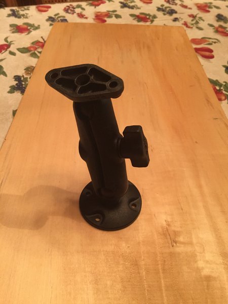

    Went home this afternoon and tore apart my dash to see about hard mounting the RAM to it. I was looking at the area above the glove box and below the air bag, as close the the center console as possible. I **think** it would be fine with a good mounting plate behind it and I **think** it would be fairly solid/shake free.
    But...
    I'm not willing to drill my dash for an "I think" so I bitched out and ordered the panavise mount. Ha ha. Thanks for everyone's input/advise.
    Here's the mount I bought.
    And the magnetic plate I ordered will mount to that.
    http://m.ebay.com/itm/RAM-Mounts-RA...%3A6bfbf2871590a6a9287ddf4fffd4dbfd%7Ciid%3A1
    I'll throw up some pics after it all arrives.

    The slug adapter isn't pressed in all the way. It's suppose to be pushed all the way in with a circlip on top to hold it in.
    Whether there's an issue with it, or they did it wrong, I can't say.

    they said even with the c clip in it keeps falling out
