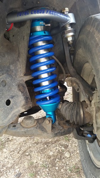

    Just rolled over 400,000 miles. Also installed extended travel Kings, TC UCA's, and new LBJ's. End link bushings are next.tmp_24883-20170105_130701-1716309805.jpg

    Post more pics of your truck, I look your file but no albums, nice kings , should be an expensive mod , what on rear shocks ?

    400K miles and new Kings/Chaos UCAs, etc! Man, your truck loves you my man! That is some high-quality TLC!! :thumbsup:
    Anything done on your leafs or rear shocks? Looking good!

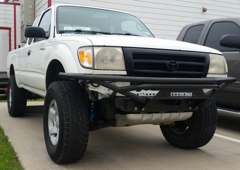

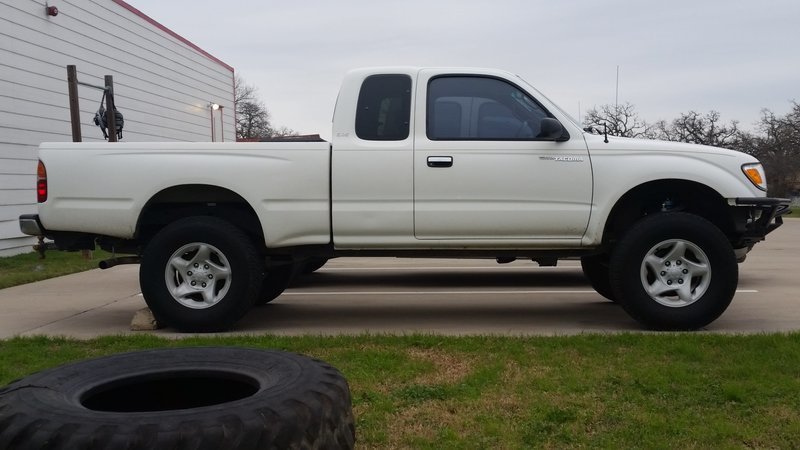

    Rears are OME Dakars on OME Nitrochargers. With the front riding like it is, it really highlights the shortcomings of the Nitrochargers over high speed bumps. I am contemplating calling Micah @Downsouth Motorsports in a few weeks and getting some Kings with resis for the rear with the correct shaft lengths and extended/compressed measurements after I cycle the rear with the Nitrochargers off. Limit straps, alignment and tires are on the list too. It sits nearly level now, with no adjustments to the Kings yet, waiting for them to settle. Here's a few shots for @Tacoma2015 before can get a build thread up: tmp_24883-20170106_091914-11291446285.jpg tmp_24883-20170106_091828-568975791.jpg

    Gary, I love it. Looks great. I have Kings on my 04 and went with ICON Progressive AALs and Bilstein in the rear. I took out the overload leaf and it rides like a damn dream.
    Let me know how you like the King rears.
