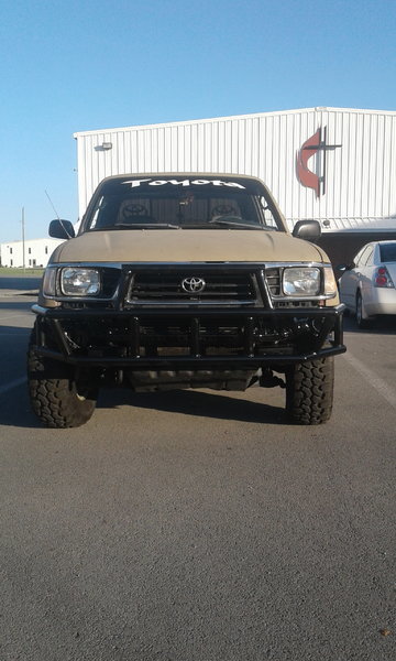

    01 SR5 TRD 4x4, '23 Bronco Wildtrak, 2017 HSQV FE350
    Drop bracket lift and booger welds
    Just don't over adjust, it's a bitch to back out again.
    Wanted that winch so bad. :p
