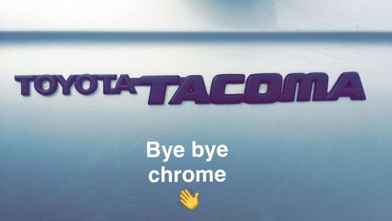

  12. Jan 10, 2017 at 10:57 AM
    UglyBetty
    UglyBetty Active Member
    Jun 29, 2016
    #190876
    25
    Pensacola, Florida
    2001 Single Cab 4x4
    Plasti dipped all my emblem/badges successfully!
    jjsul likes this.
