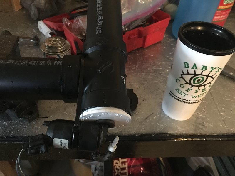

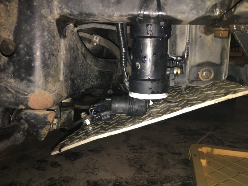

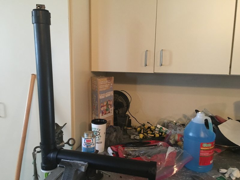

    Actually did a thing today! For the first time in 2.5 years i have wind shield wiper Fluid. It's a super tight fit with my skid but I'm planning on building a new skid in the spring anyway so I'm not worried.
    2 pieces of pipe, under 2ft. Cemented together with the 1/2" reducer at the bottom, zip tied to the frame and ps lines, and i extended the 2 wires for the harness a bit. Thanks to sir monte for his lil write up on these.
    I'm pretty skeptical on how long it will survive considering how rough I am on the truck, so maybe if done again I'd leave off the horizontal piece and just have the vertical piece and set it higher up and only use it sparingly but we shall see
