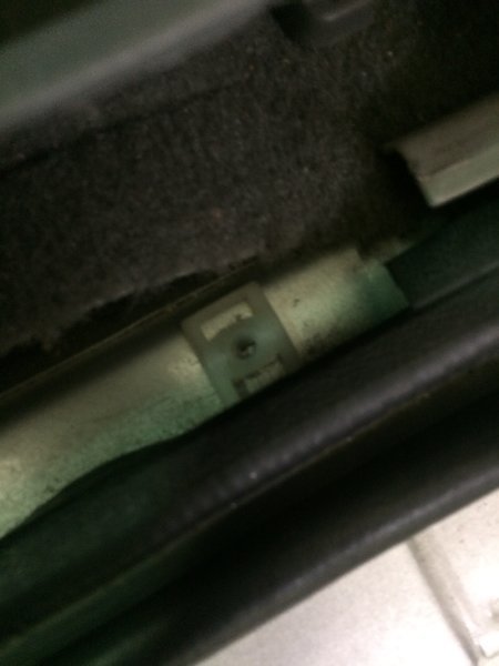

    Can you explain more? Is there a certain size nylon nut to use, or would just anything that the screw will bite into work? I think I need to do this. I just noticed that my door scuff plate screws were loose and didn't want to snug up.

    Im assuming he stripped the threaded plastic clips and replaced with a real nut.

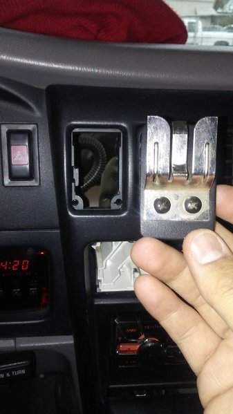

    Anybody have a part name or number for this guy

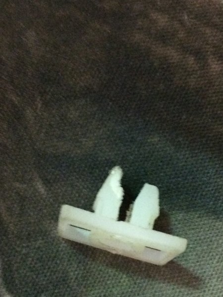

    Not sure if I quoted that right or if I'm doing any of this right...Bare with me I'm brand new to the forum but have been a long time lurker...In response to the scuff plate broke/loosening, after buying the rear passenger side at the stealership I knew that all the scuff plates were probably loose, broke, or about to break and I'd have to figure something up as a fix. I went to Lowes and where they sell the individual screws, nuts, bolts, etc; in the automotive drawers there are plastic "fasteners" (see pics). I bought those (2 pack) for like $2. Tried them out and they wouldn't fit in the hole so I took an air grinder and filed the middle so I could push it in. I also had to file off the back of the scuff plate so if will fit flush. I had to put in three fasteners (front, mid, and last hole) to fasten it down good because all of the "spreading clips" on the scuff plate were broke. Not stupid if it works.

    The black part is just the blank used for the passenger air bag switch if you don't have one it'll be there.
    Silver part is a standard cb mic hook. Quick Google will merit your results

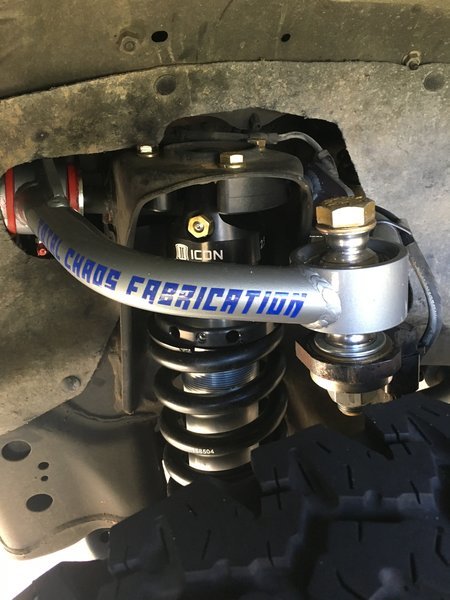

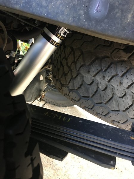

    New lift done today n uca install dakar springs n icon shocks...stoked!IMG_4524.jpgIMG_4525.jpg

    Lol...monte, i took the pic...lol...im looking for that part....took my cb out and my ocd will not allow 2 holes on my dash. Haha
    Guess i could bondo, sand, and paint as well
    Thanks brotha

    Sick!!! Please do a write up!

    Oh lol. I'm sure you can order a new one from the dealer or find one from one if the part out trucks.
