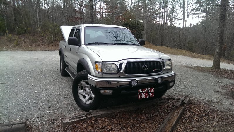

    2003 Tacoma Prerunner Double Cab TRD
    A.R.E. Bed Cover; Upgraded fender flares; PA System; spotlights on tow hitch

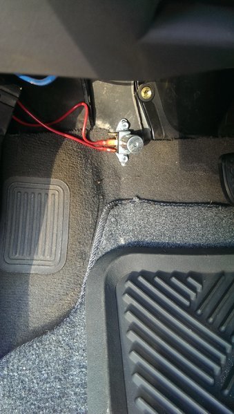

    Added some LED aux lights:
    Nothing particularly special, except for where the switch is:
    Cleaning up the wires soon. Just two self tapping screws through a pilot hole.
