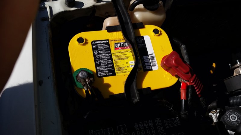

    Upgraded the battery today

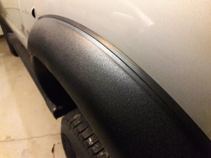

    Giving the fenders the truck bed coating treatment.

    details details details please

    That Duplicolor Bedliner you can get at Oriellys in the blue rattle can does a good job on stuff like this.

    ok to do it on the truck
    i am debating on painting mine
    currently its a smooth service with a bit of shine to it
    so was wondering if i could do that, or do something like yours

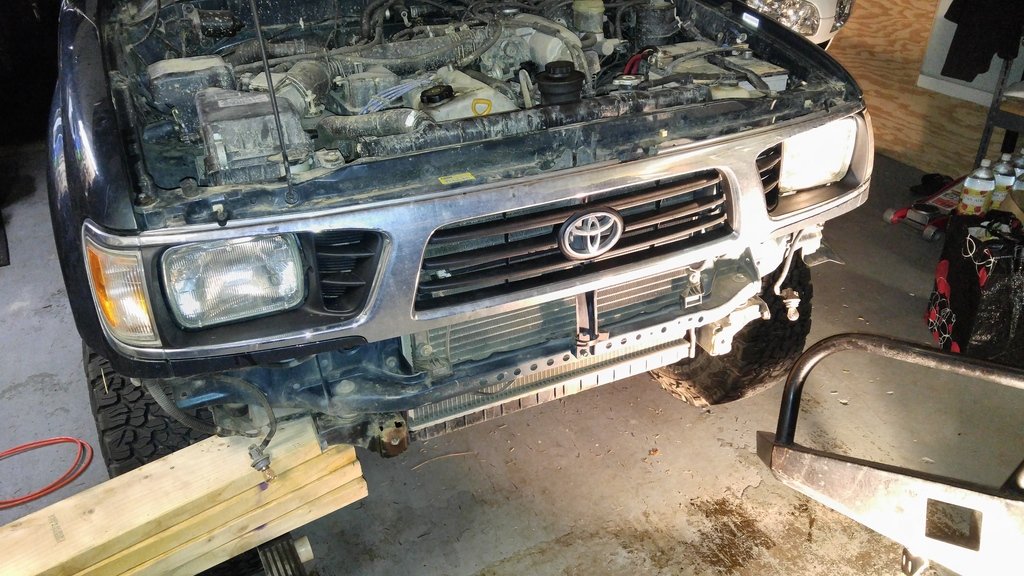

    After seeing how these attach to the truck on your year I can understand wanting to do it on the truck. Those clips are annoying.... But I would take them off and so you can avoid trying to mask around the truck and the rubber flare edge thing. You have a white truck and this bedliner would have super noticable overspray. The distance at which you spray affects the finishing texture. Looks damn good when it's dry though. I don't have flares but it's on my front bumper and I use it to patch chips on my real bedliner. Also the black portion of my grille is bedlined.
    Ignore the lack of a bumper, I masked an painted my grill from about 8-10" distance to give a light texture and this is how it came out. Pic is the only one I have that's close enough to show detail.

    Rust-Oleum Truck Bed Coating. Works great. Got the idea from @cbechtold's build.
    His post on the fender flares is from July '15. And judging from the photo in his first post, it looks like it is holding up fairly well.

    Watched a video of a guy using Duplicolor on his bed rails. Looked like a very nice finish. Very similar to the Rust-Oleum.
