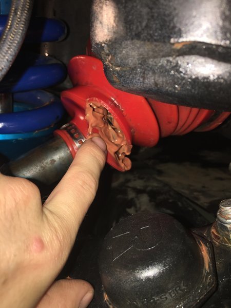

    Well f@k. Went to adjust the kings and found this gem.
    My extended boot rubbed on the bottom of the coilover annd boom

    I was just telling people how well these boots have been doing too.... Its a good thing Im a pro at swapping these axles out now I have school in a few hours. And the cleanup is super easy with this red axle grease.

    Doesnt look it was worn.

    Hard to get a picture of but from the looks of it. the flat part on the bottom of the spring kinda acted like a lathe tool and shaved the edge oh the boot till it popped. These boots like to extend far on the axle shaft. My fault for not checking for contact when I put the kings on.
    I was too excited.

    My CVJs shipped with a extra clamp and a note they may have to be moved. I had to move them in to work with my coilovers.

    Im about to do that with the otherside. I booted these my self so I have noone else to blame. I'm not sure if there was a similar note that came with these boots.
