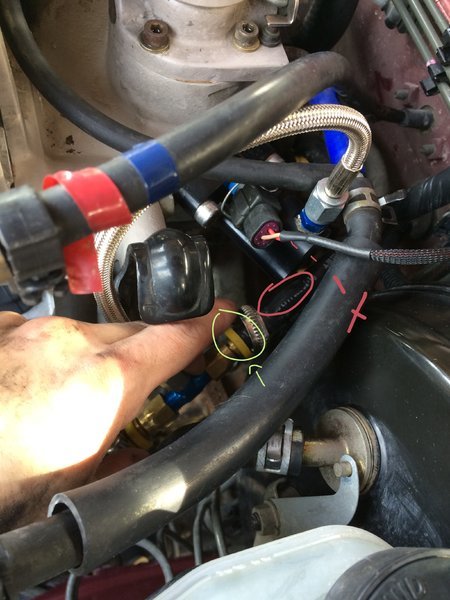

    Well it's been 2 days since its been started, would that still be an issue? Seeing as how there's been an open gash.
    I wasn't really worried about depressurization. This is gonna be a shitty depiction but I think I can cut after the gash and just reattach. My question is how do I take off this end of the fuel line from the tee labeled in green?

    Oh thats just a nipple. You need to remove the hose clamp and it'll just pull out. You can't separate the plastic from the metal part without destroying it.

    That's what I thought it was. You're talking about the yellow piece? Cause yeah that won't budge. I also tried pulling the line when the clamp was loose and also won't budge. Should I just cut after the gash and take the remaining piece of hose off like that?

    It may be easier to cut the hose and undo the T if you can get the other end off and then use pliers.
    Usually on nipple fittings espeically fuel ones they get kinda fused. I use pliers and tightly but not enough to squeeze it against the nipple and break it grab and twist to break the bond. Usually helps a lot.
