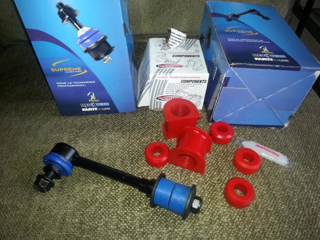

  2. Feb 8, 2017 at 4:22 PM

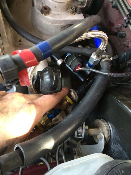

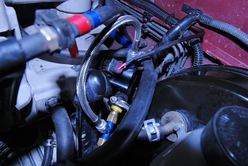

    Looks like we're back in commission! No leaks, no issues. Started her up, took it a bit to cycle through but now starts up fine. I took the end piece of the hose and electrical taped it back around the existing hose as a cushion to prevent another chaffing incident. No more corolla duty for a while :)

    You should be able to pull it out once you get the hose clamp off. Probably gonna have to use a whole lot of force by the way your having trouble with it.
    That's good to hear. My passenger side busted and have a aftermarket CV. Still got the OEM cv just really need to buy better boots for them so I can put them back.

    Good to hear. Right when I replyed lol But I actually cycle on the accessories and on for 5 seconds for the gas to cycle and my truck started right up when I installed the 7th injector.

    I'm going to guess that was the source of your occasional tough start

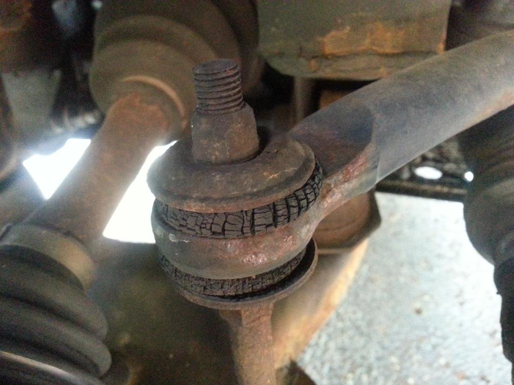

    If it's any consolation my truck has lived its whole life in Colorado and when I went to remove the end link so I can swap my CV axle, the end link shattered and disintegrated into a rusty powder mess.
    Your '04 should look something like this. Those flattened out/cracked bushings are what you're probably dealing with.
    The colored bushings are pretty much everything you should replace. Also... you might end up having to replace the actual end links because they are probably going to snap.

    Your end links are like all the parts diagrams I see. Mine don't look like that. I'll have to get a picture. Mine don't have bushings and nuts like yours. Mine are like booted ball joints from the looks of it. And it has two ends, not one and a straight stud on the other. Maybe it's a year thing? No clue.

    Well like I said I haven't started the truck in 2 days, and the gash has been sitting there open.
    More than likely not, I mentioned that it doesn't occur every start up, cold or not. It's very intermittent. The truck would've started up had I fixed this issue or not it just would've leaked a lot of fuel.
