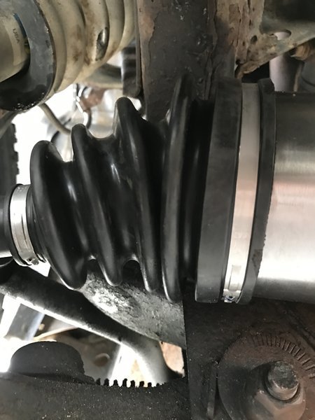

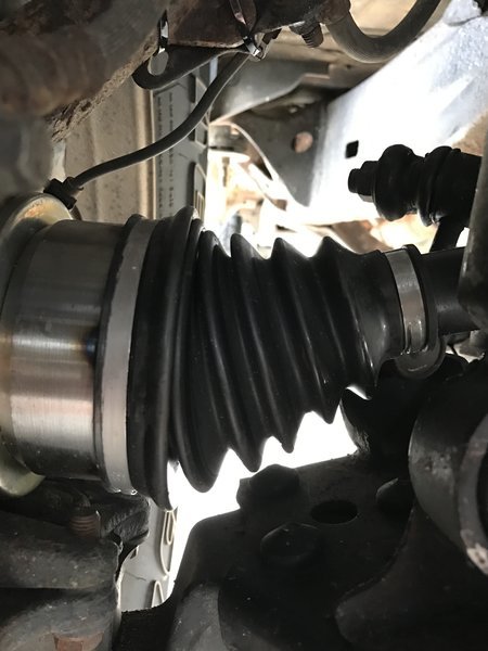

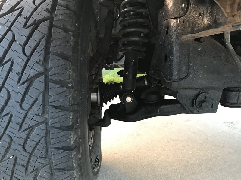

    Just a thought, that bolt going thru the bottom of the coilover, does not look factory. If it's a run of the mill SAE grade 8 from the hardware store, it may be too small of a diameter. That in turn may be causing the noise you are hearing. Or not.

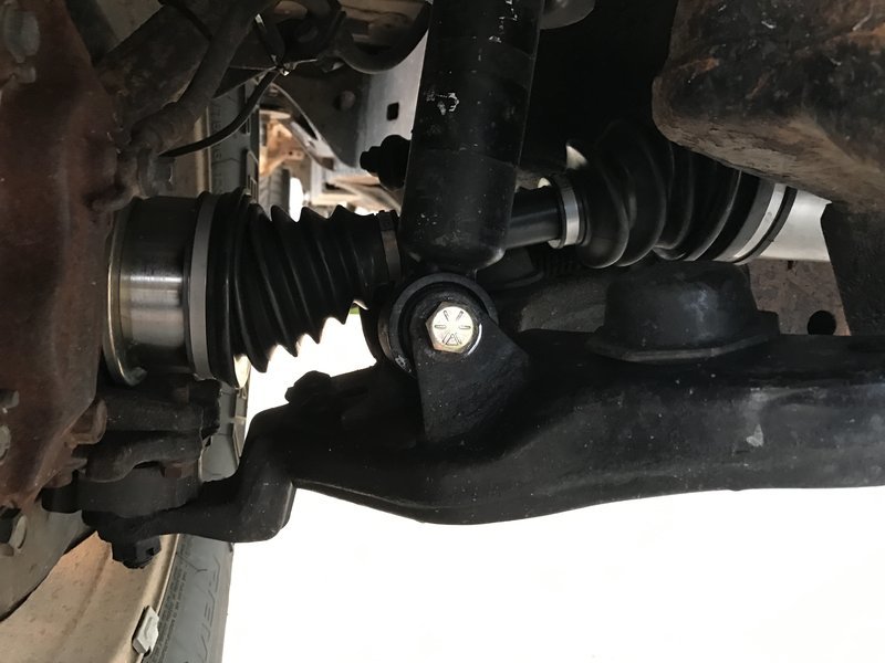

  4. Feb 15, 2017 at 2:15 PM
    TheDude22
    TheDude22 Well-Known Member
    Aug 9, 2016
    #194199
    74
    Destin, Florida
    White 04 Taco 5speed 4x4
    ARB bumper, Smitty bilt 1000 winch, KC fog lights, Custom rear bumper with tire swing. Toytec lift,
    Went out and took two more pictures and put them in my op

  6. Feb 15, 2017 at 2:22 PM
    TheDude22
    Aug 9, 2016
    #194199
    74
    Destin, Florida
    That bolt was replaced while doing the axle because the old one was rusty. Still the same noise before and after but it's a thought.

    likely your sway bar.
  8. Feb 15, 2017 at 2:33 PM

    angle looks fine to me, little to no rubbing there.
  9. Feb 15, 2017 at 2:51 PM

  10. Feb 15, 2017 at 2:53 PM
    TheDude22
    Aug 9, 2016
    #194199
    74
    Destin, Florida
    The bushing do look a little smashed up and dry so maybe that's the problem
  11. Feb 15, 2017 at 2:57 PM

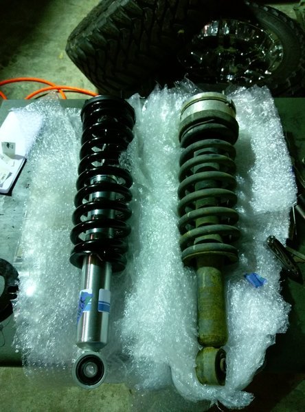

    Replaced my stock struts and spacers with 5100s and 881s :D

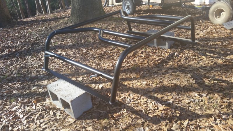

    What fabricator for the rack?

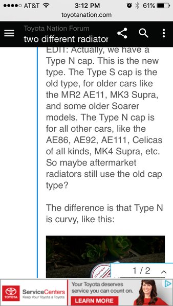

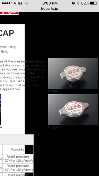

    Ours should be the N type. I wouldn't compromise a radiator under pressure with the wrong size. Now just to figure out which pressure rate to go with. The S type was for older models like the supra that was rated for 21.3 psi (1.5 kg/cm2). The N type is offered at 18.5 psi (1.3 kg/cm2) and then there's one for I think 12 psi. Good info to keep in mind.

    Stock normal one is 0.9 BAR or 13.05PSI, that's what I have. I'd assume you're looking for higher pressure

    That's what I figured. So now I'm set to get this radiator installed.

    Which size spacer were you running? And how would you describe the difference between the feel of driving on road?
  19. Feb 15, 2017 at 4:04 PM
    CStoy
    CStoy mountain-top maniac.
    Jun 11, 2015
    #157225
    381
    majestic gold 4x4... 1/4 million miles and counting!
    improved toyota goodness.
    just a hunch... that strut bolt on the bottom is not factory... on an older truck I made a mistake of replacing the strut bolt with a standard parts store grade 8 because it was cheaper at the time
    it clunked pretty bad even though it was as tight as I felt would not twist it off with a 4 foot bar - it was only half a mm smaller than the stock one...
    edit: oops was beat to it
    TheDude22[QUOTED] likes this.
