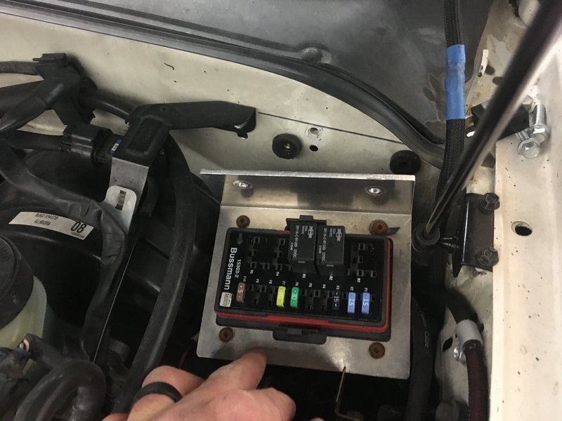

    Depends on how much time and electrically inclined you are... I honestly could have wired it up like the one in the dyi the ad but, I don't have that much time and this worked very well... so I went with this one from Tacoma pros at http://www.tacomapros.com/bussmann-rtmr/ I am super happy with it really cleaned up the engine bay with not much room to work... with the stupid charcoal box... I used the mounting plate but had to cut it in two to split the buss the breaker due to space... I have 3 set of rigid lights on relays with two left. Shell lights and hood lights on just fuses with two left illimitable switches took one. I really like the switch plate he uses but I don't have room for it on the dash plus there are 3 holes in my kickplate already... I did mount a grounding buss and used the Delphi connection for the leads but wish I would have used something slimmer and less bulky, after I decided that the simple blade connection wasn't good enough....Maybe the square ones the rigid lights use... Just my two cents... I would check this thread too... https://www.tacomaworld.com/threads/lets-see-your-1st-gen-switch-setups.266742/page-9#post-14095300
