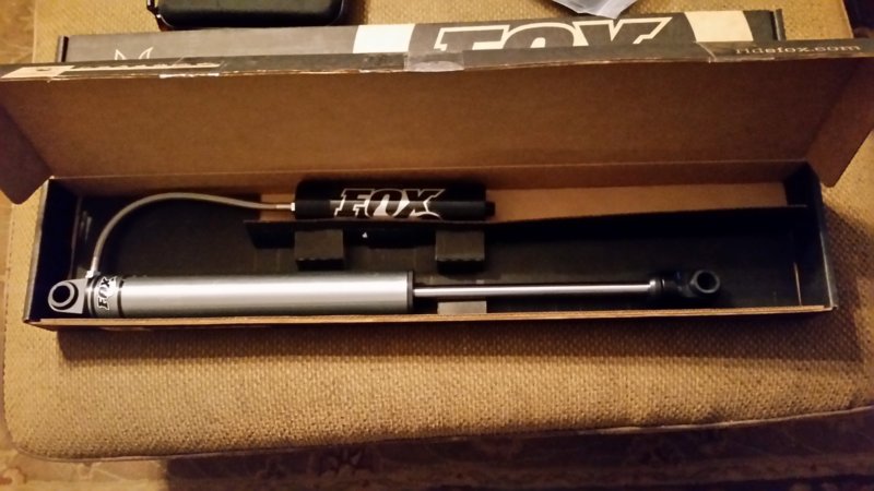

    Fox 2.0 Factory Series 10" Travel
    Smooth Body shock Remote Reservoir
    QMEDJoe, Seebema, Jaysjammin and 6 others like this.

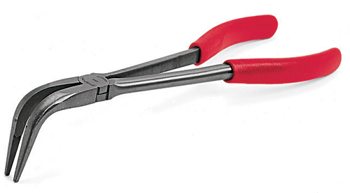

    Seems like the ball joint type part of the tie rod end itself is spinning. I ran into the same issue. See if you can hold the non-threaded part of the stud with something like this.
    http://public.snapon.com/R_RRD/Objects_lg/images/490ACP.jpg
    The angled part may or may not be necessary. You might be able to do it with a regular needle nose. But I like the approach the angled nose gives. Either way, you wanna hold the stud free so it does not spin and then tighten down the castle nut with a ratchet.

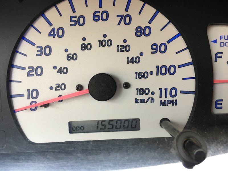

    Not sure how many more miles she's got left in her :mudding:
    Just getting broke in lol
    It'll take me forever to get 500,000 ... I've had it since July of 14 and it had 127,000

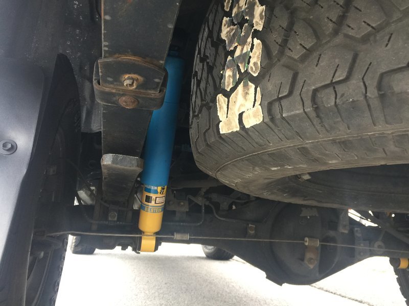

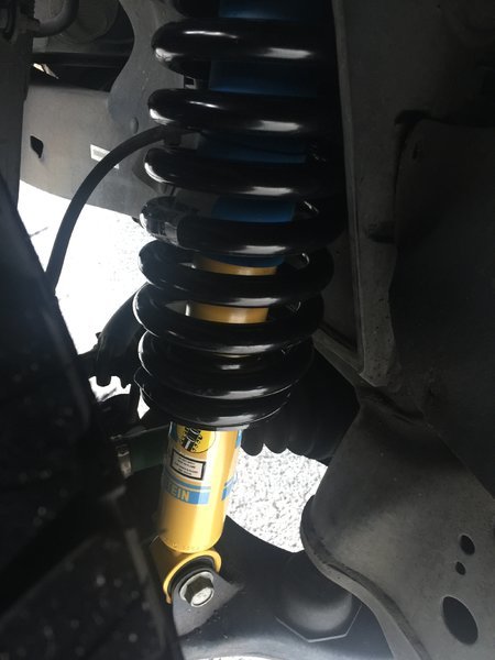

    Got some 4600's on, new springs, top hats, and an alignment. Did a tune-up with an ignition coil, as well as a 3-step fuel system treatment and parts clean.
    She's well taken care of!
