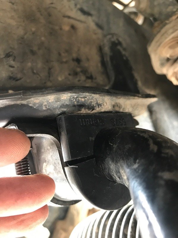

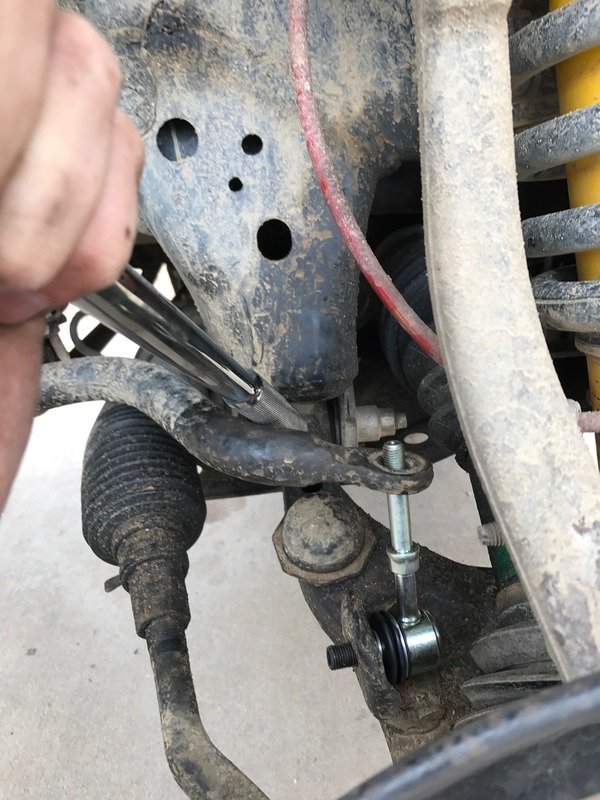

    Replaced my sway bar end links and all bushings.
    Few questions/concerns:
    1. Prior to the swap out I used to be able to articulate the sway bar by hand. Was this an obvious sign of worn out bushings?
    2. After the swap out I couldn't make the facking thing budge if my life depended on it. Is this the way it's supposed to be or is it too tight? See the first picture. In order to manipulate the second side swap into place I had to wedge the breaker bar on the sway bar and literally lay all 200 lbs of my big hunk of love on top of it while I placed the top bushing, washer and nut.
    3. The big "D" bushings is where I'm concerned. After much searching here and talking with Energy Suspension, I ordered the 26mm kit (rather than the 27mm). However the stock bushing I took off has "26.4" stamped on it. I'm assuming that's 26.4mm. Also the same bushings that Tim gave me off his 2004 has "27" stamped on it... again assuming that means 27 mm. Did I get too small of a bushing when I got the 26mm? See second picture for the gap that does not exist with the 26.4mm stock bushing. I did grease the hell out of the inner diameter of the bushing.
    All in all it feels 1000x better on the road. No body roll, solid tracking, etc.
    I'm just concerned for very little articulation when off road compared to the stock set up. Or am I overthinking this too much because the lower control arm and force will make that sway bar move?

    A genuine TRD package sway bar takes the 27mm bushings. Standard is 26mm, that might be making it on the snug side.

    Son of...
    Thanks. I might get the 27mm ones and replace them.
    Where the fack was this information when I was searching the forums endlessly for the size? :oops:

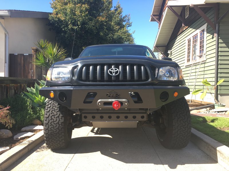

    Bumper went on about a week ago and after a bit of a mounting issues with the control box on the winch...had the shop relocate it. Been waiting for the new grill to show up since the other one got cut up...finally all black in the front...tomorrow rear bumper and pretensions the winch
    Finally loaded my winch n put on my yota symbol
