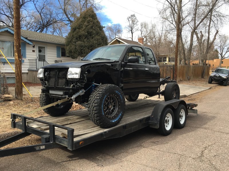

    As for progress today, swapped rear tires and loaded it up on the trailer. Not the easiest to get up the ramp with bald mini tires and 2wd LOL. Then put it back in the driveway. Trailer conveniently inverted a shackle so fixed that. Then dropped the gas tank and driveshaft in record time.
    Had to remove the new crossmember because it was right where the new spring mounts needed to go. Derp
