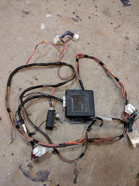

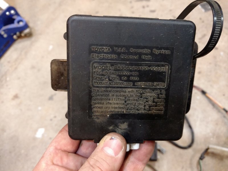

    Reserected from the dead.
    Here is a couple pics of the box, plus all the wiring that comes with it. I don't know where the remote is.
    But yeah, pulling that out is definitely worth a six pack.IMG_20170223_020432.jpg IMG_20170223_020450.jpg

    I'd say more towards a 12!! :gossip:
