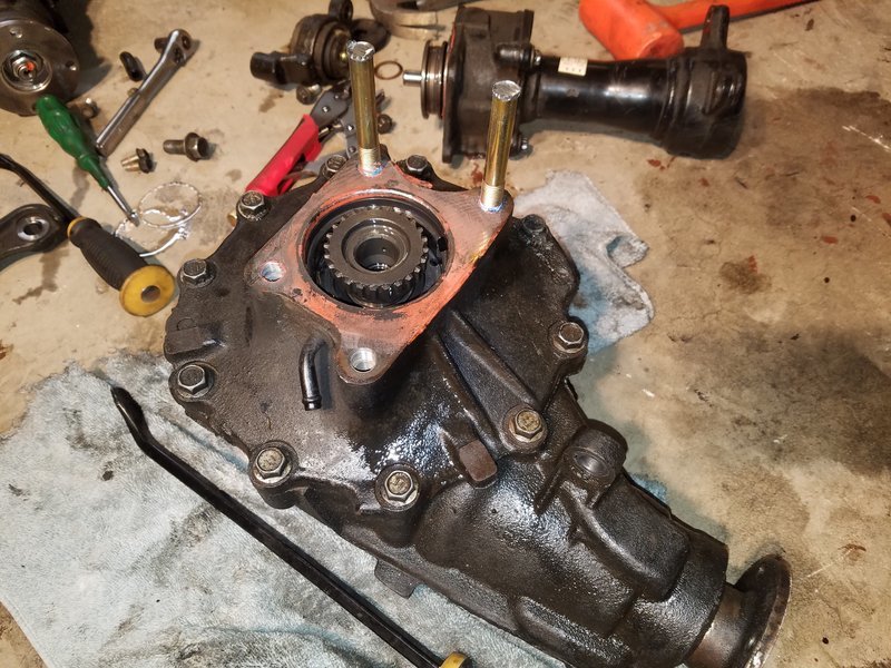

  12. Feb 25, 2017 at 10:57 AM
    j0shu4
    j0shu4 98 TRD 4x4, 3.4 Turbo, Full LT, Fully Locked
    Dec 21, 2014
    #144706
    1,995
    98 TRD, Turbo, 3.4L, 4x4, LT
    Turbo, Fiberglass, Full Long Travel, Lockers, T100 axle, King Shocks
    Can someone tell me how this gear comes out of the front diff? Trying to transfer everything to my 4.88 ARB......

    Use two large screw drivers on opposite side and pry down hard. It'll take more error than you think. Sucker may fly out at speed so be ready. Snap ring on it is a big one.
    Have photos of this I'll try and post

  16. Feb 25, 2017 at 11:15 AM
    j0shu4
    Dec 21, 2014
    #144706
    1,995
    :rofl:
    I was sooo hoping you'd chime in.....thx man.....!!!! Ive been prying on it but not super hard. Didn't want to break a tooth or anything.
    "May fly out at speed." Lmao....
  17. Feb 25, 2017 at 11:16 AM
    Blackdawg
    Blackdawg Dr. Frankenstein
    Dec 31, 2010
    #48500
    81,649
    Monte
    Wyoming/St. Louis
    The Trifecta of Taco's
    Yea. One of those things that takes more effort than your originally comfortable with.
    Two long big screw drivers will pop it out though.

  19. Feb 25, 2017 at 11:20 AM
    j0shu4
    Dec 21, 2014
    #144706
    1,995
    Got it. Thank you buddy......
