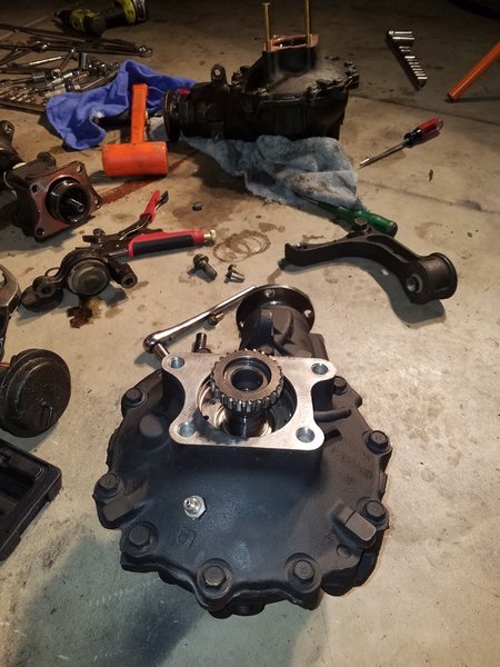

    I'm in the middle of putting them back together right now. I had to redo the resi out puts. Figured while I had the front diff out and everything dropped I do the shocks, bumps, and relocated my limit straps

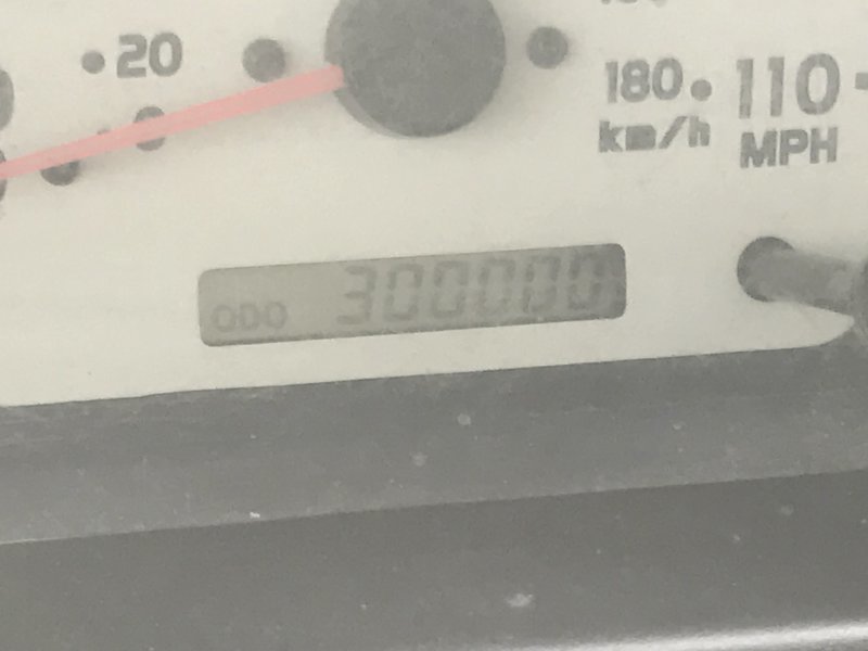

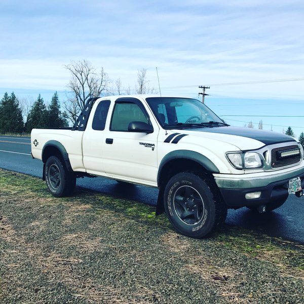

    IMG_8280.jpg IMG_8281.jpg i drove mine over 300,000 miles

    Congratulations! And I dig the truck. The decals and w/e those things atop the bed are called really work for me.

    it's a headache rack i got from gorino i think it was like $250 or something. thank you it.
