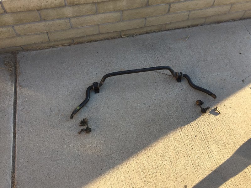

    When @a.a.lee and I changed his in the desert we had to remove the 2 front diff bolts to make room to get it out and the new one back in. With the 4 bangers there's enough room that you don't need to do that.

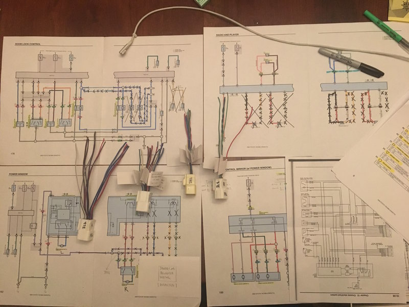

    Taking on the huge cluster-f that is converting my manual windows/doors/locks to full power doors. Found a member on here with a wrecked '04 Limited and took all the door components from both doors, and cut the kick panel connectors pigtails to solder wires to. So far, it's involved me staring at the factory service manual and complete wiring schematics for hours upon hours trying to figure out and to label what each of the almost 50 wires spread over 4 connectors connect to, and do.
    I'm bypassing the RS3000 module and integration module since I don't want to re-run a majority of the cab wiring harness so I'm going to be using a Viper keyless entry system to control the lock actuators. The integrated circuits (IC's) and microcontrollers present in the power window master controller and the mirror master switch should theoretically operate their respected assemblies with the presence of +- 12VDC.
    Here's my progress:

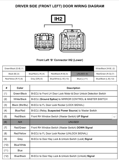

    Here's one of the connector pinout charts I'm working on:
    The truck I got the wiring out of was a Double Cab and I have an Extended Cab so eventually I want to motorize the rear vent windows by grabbing the window linkage and motors out of say a Ford Windstar and adapting it to the truck.
