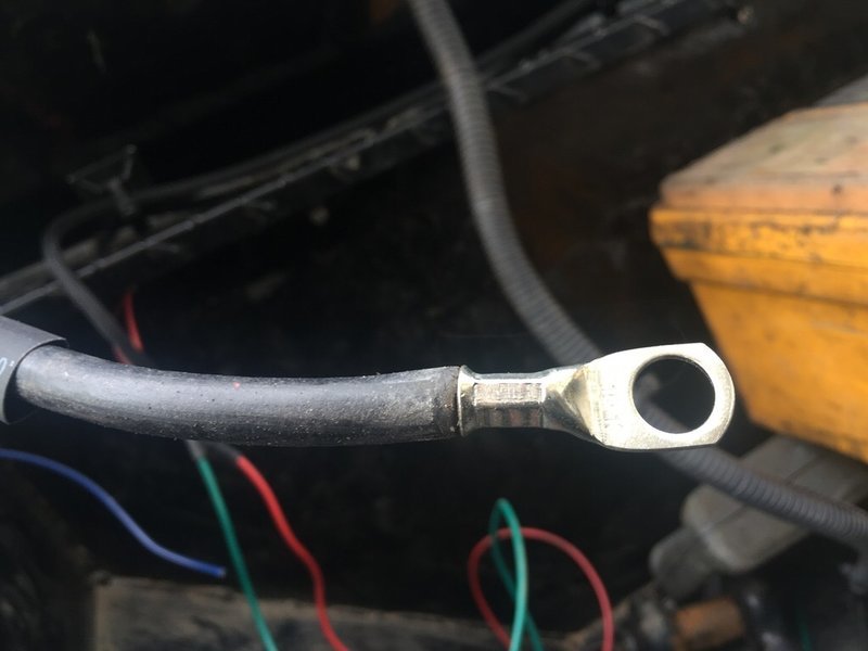

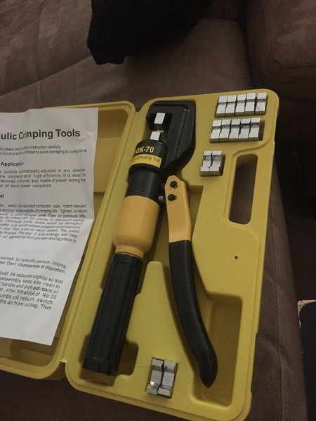

    All of this. That's the same tool I used too and it worked great when I added an aux panel to my tool box.
    Great tool for the price. I guess I'll pick up some 2 or 4 and some lugs. I don't really wanna go to the gm alt without having the wires upgraded to take the juice.

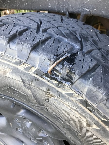

    I had a awful knock/chatter when accelerating so I cleaned my MAF which took care of it but I noticed a small bit of green/corrosion on it. Something to worry about? I also found this bad boy in my tire this morning.. not a good way to start the week IMG_0313.jpg

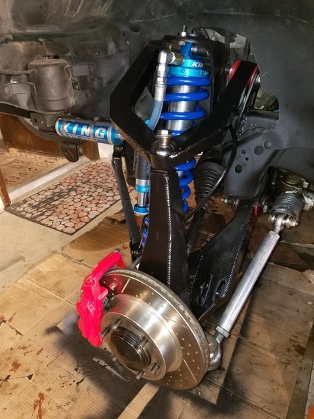

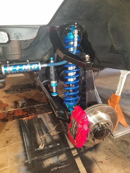

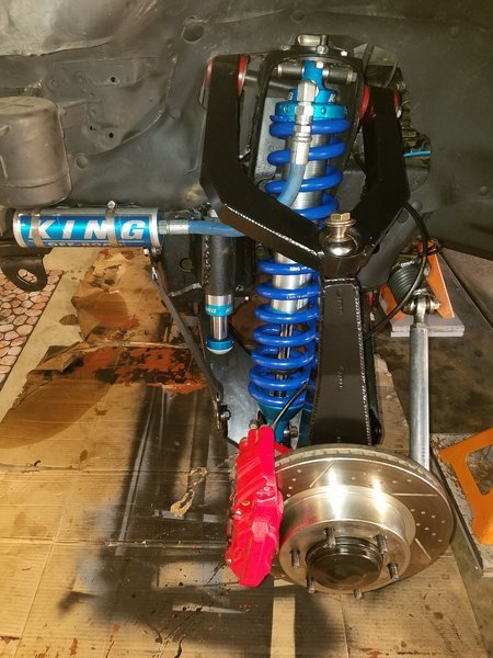

    About 5 days worth of work. Got my new front diff in (ARB, 4.88), plummed ARB, 2" King bumps, redid limit straps, 90° down resi outputs, cleaned up shocks.
    Looking sexy as f....... Next stop will be triple bypass secondaries and re shimming the coilovers. Might be a few months before that happens.

    Mother of god /\

    Yep, soldering high amperage connectors is at the bottom of the pile. Along with the conductive properties of "cold weld" the connection is mechanically maintained. It will not fall out and say, start a fire when the solder melts as you winch your way up K2.
    Soldered high amp connections are not allowed under the national electric code for that very reason.

    This too, along with thick wall lugs intended for crimping and correctly sized for the wire.

    Darn, that sucks. I would not take it to a chain tire shop (Goodyear Dunn...) if you want to get it repaired. The industry rule is that you can not fix a tire that has a puncture closer than a thumbs width from the sidewall. I would personally use a rope style plug but if you want to go the absolute safest route, replacing the tire would be the way to go.

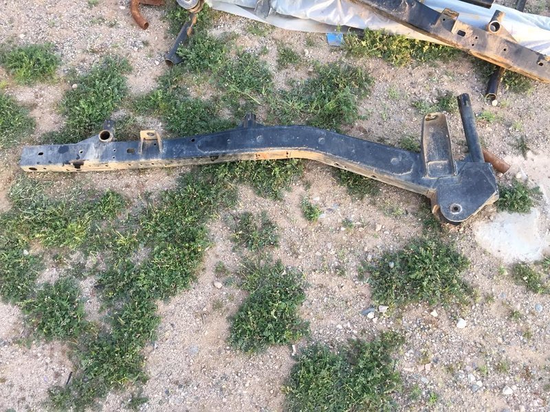

    Was yesterday but cut some pieces off :)

    So I'm getting 10ft of 2 AWG, and 10 lugs, and going to run a 150 amp CS-144 from a vette I found. Should be good to go, correct?

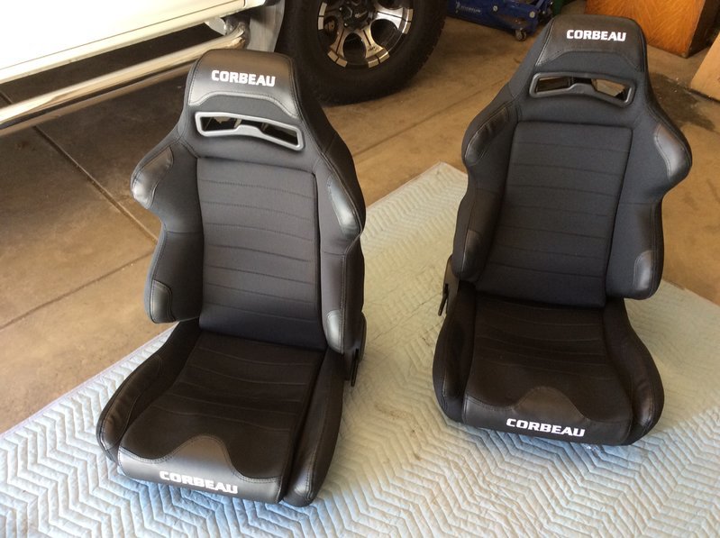

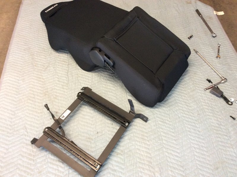

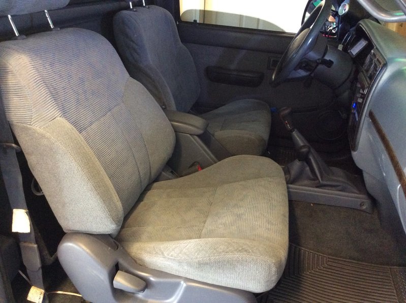

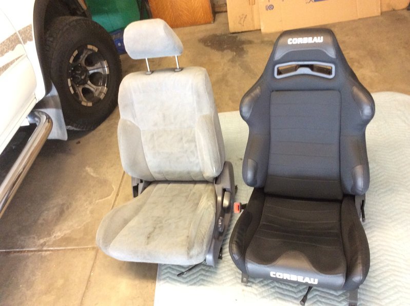

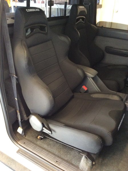

    Got my corbeau LG1 seats installed today in my reg cab, took an hour to do,
    Fit like a glove, what a difference

    Direct fit?
