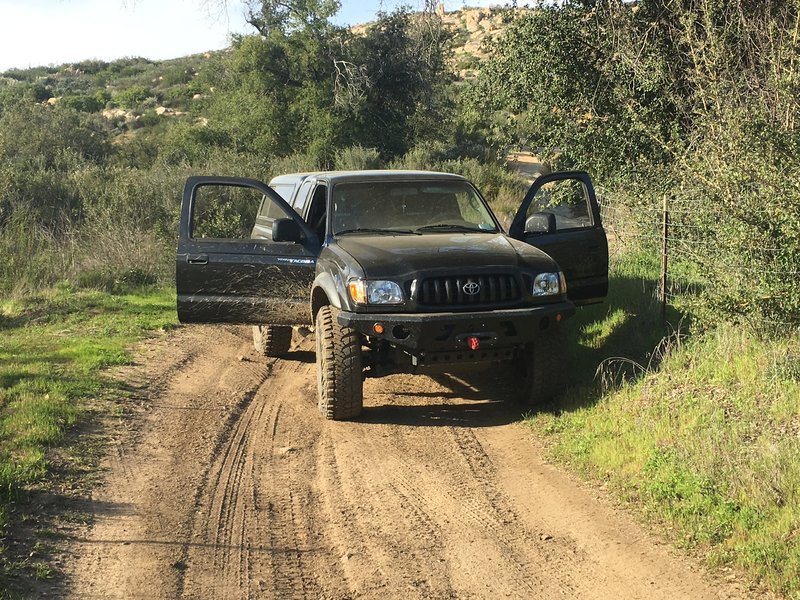

    Tested out the new taarres

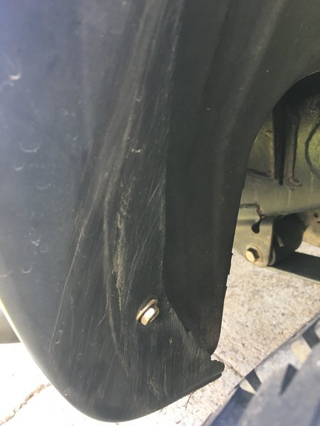

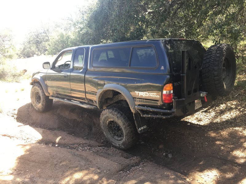

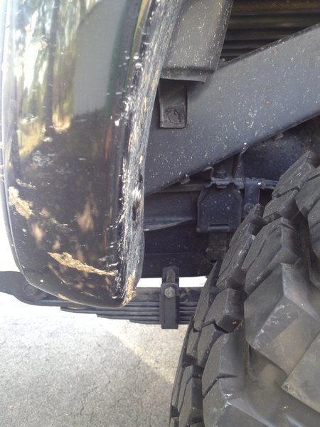

    Got home and cleaned the shit out of it mud is fun, but a bitch to clean...and it couldve been way worse haha...though I recognised this in the rear wheel well...obviously heard it too when weeling, any suggestions on how to not have it rub this bad w 33's Add a leaf? Cut? Bumpstops?

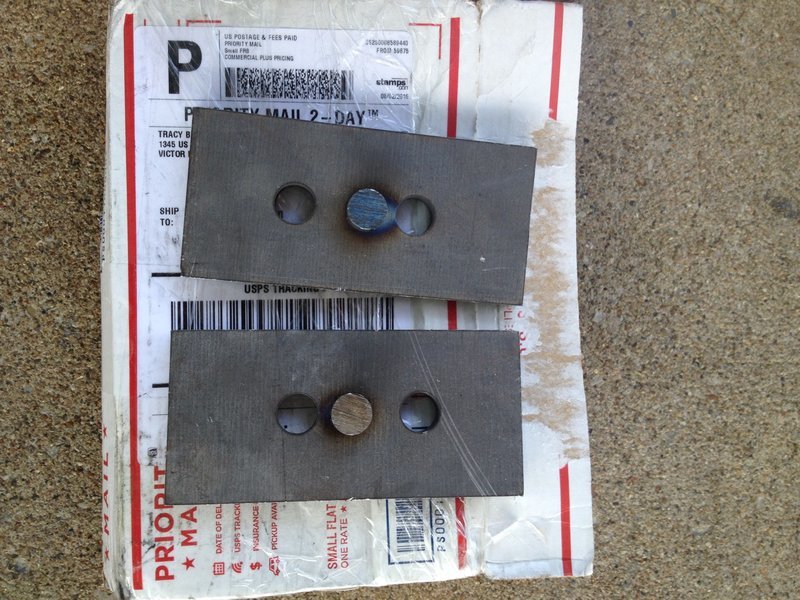

    Axle relocation plates.
    Got mine from all pro, but I think there are other vendors as well.

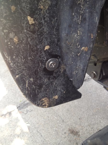

    Also, you can replace those hex head flare bolts with flat heads so it will sit flush.

    Just head to the hardware store seems like a good first step haha looks like you get 0 rubbing on your rear front well

    Yep. But it looks like your rubbing the flare too. Moving the axle a tad is probably your best bet.

    Cut them. Thats what i did

    Can you post a pic so I can get an idea of where you cut

    You got them tars on backwards, bud. Read the sidewall, it says "this side out" on (what should be) the outside of the tire.

    Shit haha well at least i didnt put them on...your taco looks sweet did you have rubbing on the fender flares at all? Is that why you took them off

    My truck is all hacked now. Lol.. I dont have fender flares anymore

    Yeah 35's rub the fenders something fierce. Got em all trimmed up now though, just have to paint some bedliner on and stick them back on.

    I have 33"s and the are rubbing :confused: and backwards :facepalm:
