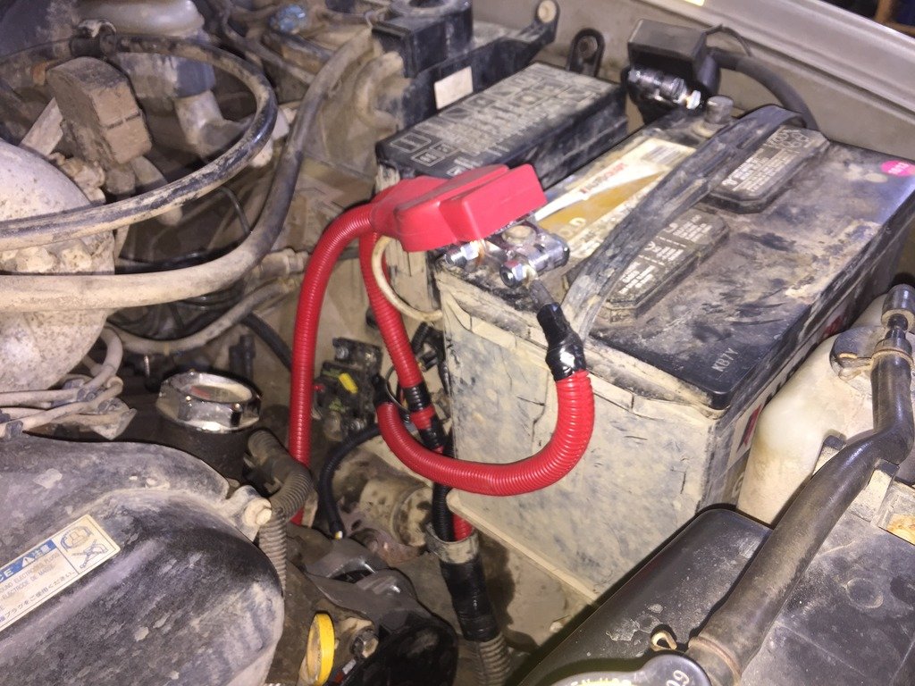

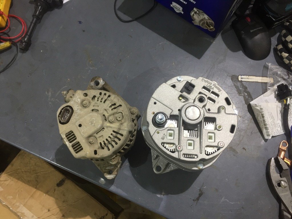

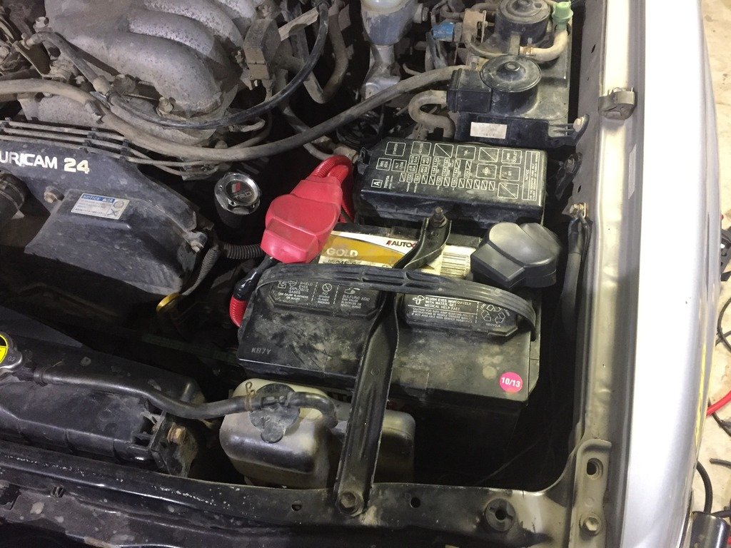

    Got my CS 144 in today and big 3 wrapped up. Only wire that wasn't upgrade was battery to fuse panel. The lugs I had were too big for the bottom wire in bolt. I figure this is okay to leave as is since it's not drawing anymore than it originally did. Is this a correct assumption @Blackdawg and @Digiratus

    So to install the alternator you just used the adapter connector and the rest is pnp?

    Almost. You need to make a spacer for the top bolt and of course upgrade your main harness to handle the amperage.

    Mine is not hot at all. I could easily touch it. The temp gun pegged it at ~80*F. A lot cooler than I thought it would be.
    Yes, you will be fine. Mine still has that stock wire too.
    IIRC, you have a large gauge wire running from the alt direct to the batt, right? That is the way we did ours.

    Yup 2 gauge straight to the alt, engine block and starter.

    That sounds pretty good. 2-gauge may be a little more than you really need since its such a short run for 150 amps max, but it certainly hurts nothing..
