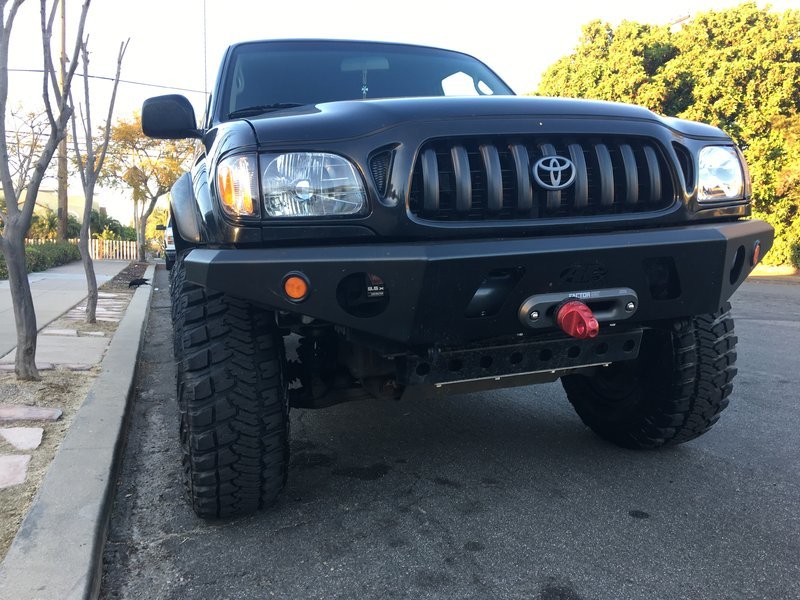

    Nice! Looks good man. We even got the same bumper.

    What bumbers is that?

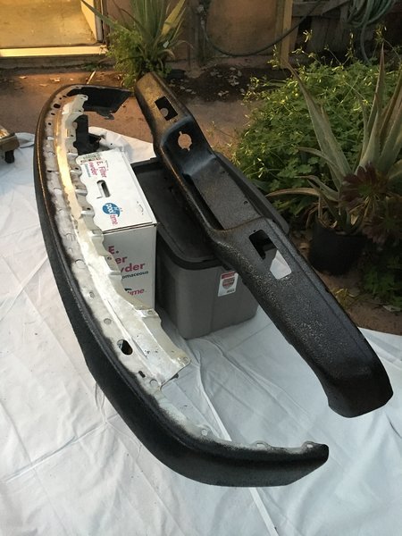

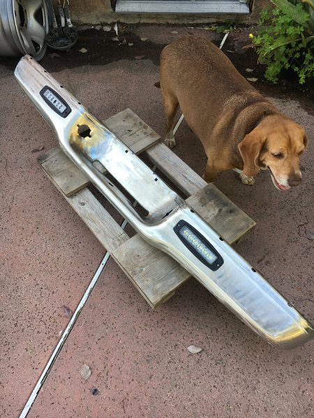

    Finally got around to working on my new-to-me bumpers, buh bye chrome!
    I scuffed up the chrome with a sanding disc on my grinder, it went really fast.
    I had already cut out the holes for the back up lights.

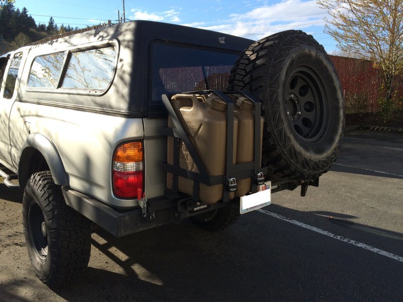

    Who made your rear bumper?

    Allpro apex front bumpers

    I did, it's a pretty simple affair. 4x2 tube, 3/16 wall. The swingout is all 2x2x3/16 if I recall correctly, the jerry can rack is made out of 1.5x1/8 flat bar.

    I don't know if it's just me, but I like the Chrome on the Tacoma. It's not overdone, and gives you some contrast that otherwise won't be there.

    I like it on the grille and door badges other than that I feel like it is trying really hard to be what it isn't. The bumpers may be chrome but they are tinfoil, unlike the chrome bumpers of old. I don't know, but my thought is that they were going for the good ol days nostalgia factor of chrome bumpers on a pickup truck.
