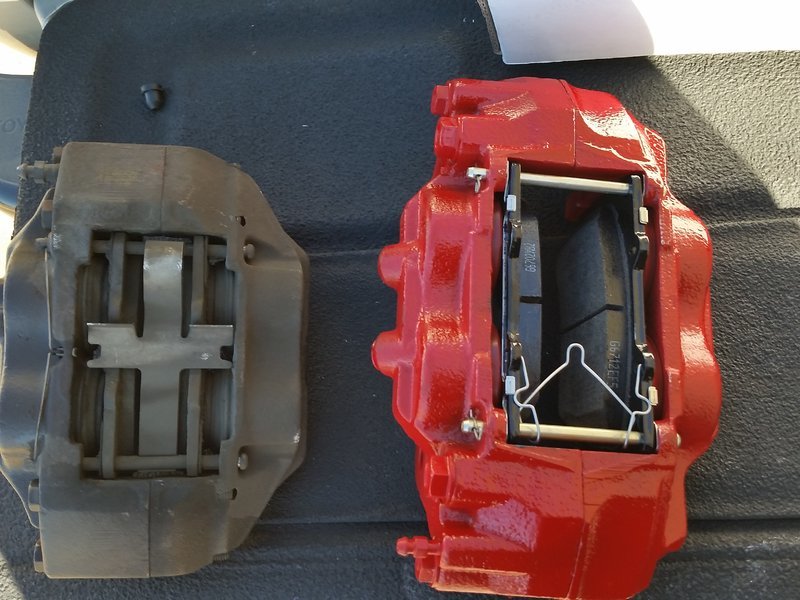

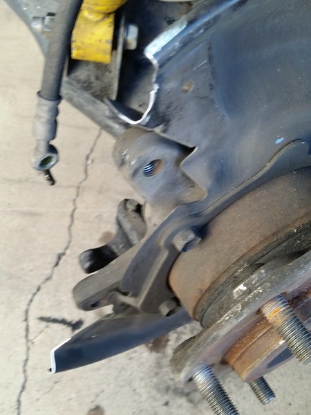

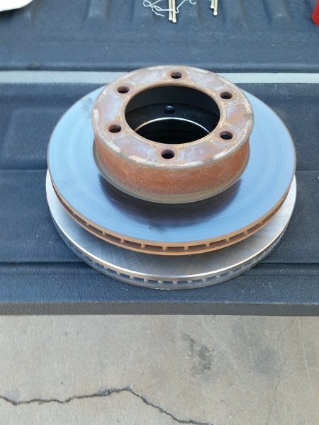

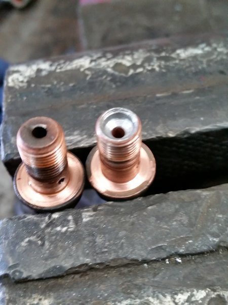

    13WL is for the bigger diameter rotor . You want that. I modofied my banjo bolt a little to make it work. 20161029_140401.jpg20161029_134910.jpg
    rotors i used
    Caliper differance.
    Trimmed area if backing plate

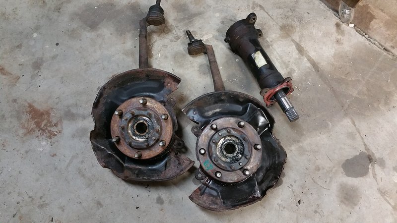

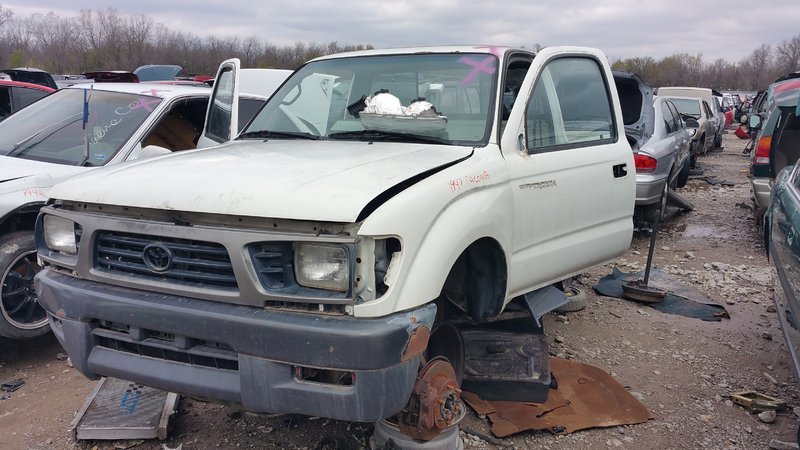

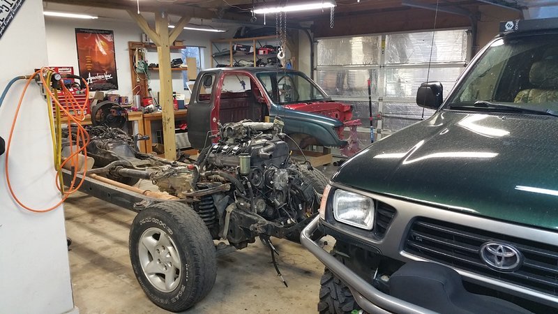

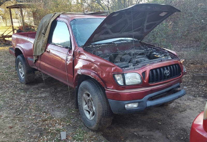

    Scored some manual hubs/spindles,fenders,hood and front end for my in progress "F-Storm" build from a 97 standard cab 4x4 at a pick and pull junk yard. All for $180! Not sure why it was even junked unless the motor was blown. Tried to buy the whole cab and frame but they said no, because of the liability with the salvage title.
    Anybody local hit me up for the where.204k on the truck.They want $59 for the near mint cond. doors although they aren't powered,$120 for the fr diff and $120 for the j shift transfer case. Half a mind to go pull them for spares as if I don't have enough parts hoarded!lol
    F-Storm build will have a 98 cab ,97 front end going on a 01 TRD 5sp drivetrain with it's stepside bed. Complete dismantle frame off, prime and then paint with Hot Rot Desert Storm flat tan urethane paint.Will take awhile to do it right.
    20170312_123111.jpg 20170314_192235.jpg 20170314_191828.jpg 20170218_1749171_cr.jpg
